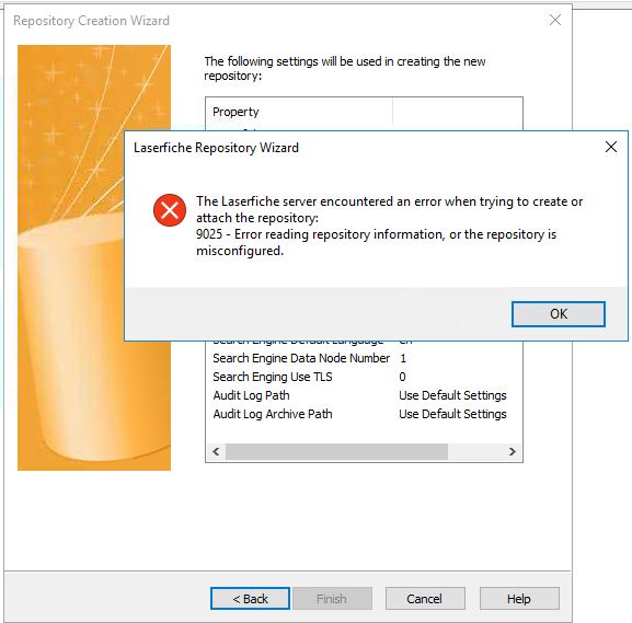

The database has been previously created by the customer with an SQL account assigned as dbo to connect and create table schema.
When I execute creating the repository the error in the attached screenshot is displayed.
Also the following error is logged in Event Viewer;
There was an error creating the Laserfiche repository "Payroll". Function=ALTER DATABASE [laserfichepayroll] SET RECOVERY SIMPLE; Error=0x5BC; [Microsoft][ODBC Driver 11 for SQL Server][SQL Server]The operation cannot be performed on database "laserfichepayroll" because it is involved in a database mirroring session or an availability group. Some operations are not allowed on a database that is participating in a database mirroring session or in an availability group.
The repository isn't created.
Many thanks for your help

replied on May 10, 2019
That looks like a bug in the Laserfiche Server where it always tries to set the recovery mode to simple. Reference ID 171096. We'll try to address it for the 10.4.1 release next month.
In the meantime, I think you can temporarily disable the multi-availability zone feature of the database and reenable it after the repository is created.
Seconding Miruna's point about temporarily disabling Multi-AZ on the RDS instance, as that feature implements database mirroring/availability groups on the backend.
I have successfully created many repository databases on RDS with Multi-AZ turned off.
