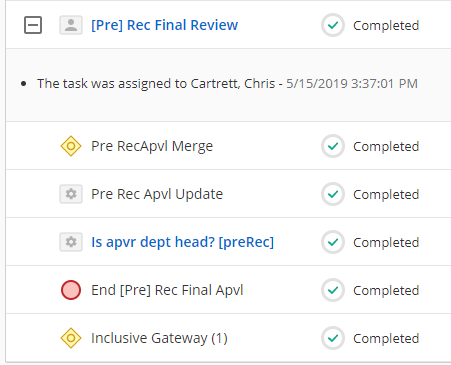

Here is another indication that your process is malfunctioning. If you suddenly show a subprocess with the end of an arrow just floating, then you are in trouble:
From what I can tell, this is an arrow that points back to itself and you can't edit it. It DOES show in the step as a path:
I tried putting some ridiculous logic in there so the process would not go down that path, but it had no effect. When I sent the form through this subprocess, it essentially split my path and froze the form:
It doesn't throw an error. I am going to assume my instructions are to upgrade to 10.4 which is not an option for quite a while. I am going to attempt to recreate the subprocess.
Hope this keeps someone from going crazy one day. Total bummer.
replied on May 15, 2019
Unfortunately you are correct. The arrow issue is actually a different issue that we fixed in 10.4. If you find a stable way to reproduce it, please let us know. In 10.4 we added the ability to delete that arrow and included it as an error when you validate your process.
