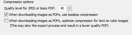

Further, I've played around with compression upon export of image pages to pdf, but I'm finding nothing working. For example, my settings are the following:
but a 21MB monochrome image file is still exported as a 21MB pdf file.

I don't have a formal recommendation for you, but can tell you the guide rails I used when coming up with some of this.  The default settings for our higher volume scanners results in some significantly large PDFs.  On the order of a few MB per page.  Recently, I've made some adjustments to the default settings and tuned the DPI down from 300 to 200 which resulted in a significant reduction in file/pagesize and not in noticeable quality.  Given you mention that your OCR'ing these, I would recommend some testing to see how the OCR engine does as you make adjustments.

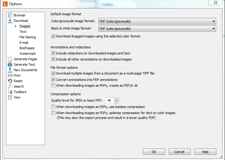

I believe you are not seeing adjustments in the output file because you have the lossless option selected.  Try unselecting it and Download/export some PDFs as you refine the quality percent and see how that does with regards to output file size.

I tried selecting the lossless option, but still ending up with the same file size (21MB). Am I missing a different setting perhaps?

Are these TIF images?  For kicks, try adjusting the 40 to 10 and to 90 then perform a download.  I would also be curious to see how the output changes (if at all) with the second checkbox to optimize compression for text on color images.

Yes, these are TIFF files. I tried adjusting the %, with no changes. Whether that second checkbox (optimize compression for text on color images) is selected, makes no difference either.
Trying a different document: same results. No changes on size given the different settings.

The conversion from PDF to TIFF inevitably causes a large increase in image size, and the subsequent conversion from TIFF back to PDF does result in a larger PDF than the original.
The strange thing is that the PDF should almost always be smaller than the source TIFF pages. 21MB sounds pretty large for a monochrome file.
Note that unless you explicitly tell Laserfiche to convert the PDF as monochrome (TIFF Group 4), the resulting pages will be color TIFF files (TIFF-LZW) even if the underlying image was monochrome.
Monochrome pages are significantly smaller than color so it is possible that you're not actually generating true "monochrome" files at all. We scan a lot of documents in monochrome and the PDFs are only in the KB range.
