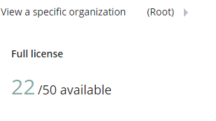

Another request for an update on this. That DB query is a good starting point but doesn't include things like licenses assigned to a specific LF Server or organization. And as Brianna mentioned, it doesn't count total licenses (though I can get that through LMO).
Basically, I want to be able to see the count of full licenses that shows on the main overview page of LFDS. And then give you more money when that number gets too low.

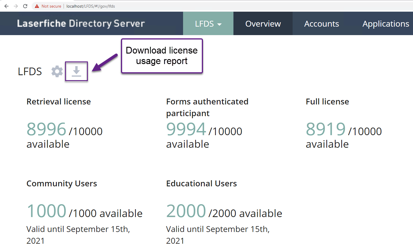

I spent a while on this and figured out how to automatically generate the same CSV report you get by clicking this button:
This PowerShell script gets you the data in CSV format. You can then use the data to generate whatever metrics and alerts you want. I trust you could figure out how to adapt it for a Workflow web request or similar if desired to meet your needs.

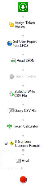

I wanted to run all the logic form within Workflow, and from threads on here, running a PS1 script from WF seems problematic. So I converted the web call in that script to a WF web call, write the output to a known CSV path, then query that CSV and compare counts. Probably could skip the data steps if I was better with c#, but I think this will work quite well for my needs.
Thanks again for the assist!
