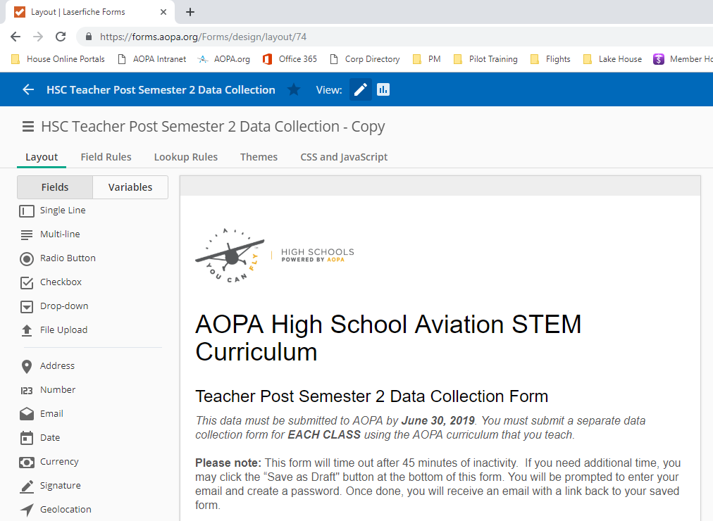

I have this same issue on a couple different forms. I've tried different browsers and cleared cache and it has not helped.
Issue: I cannot update my form as it won't save any changes. I've noticed that when I click preview from the form editor, it will open an about:blank page and never loads the form to preview. The preview, however, does work when I'm in the CSS and JavaScript section. Still though, I can't make any changes to the form because they won't save.
I have also found on a couple of my forms (they all mostly use the same custom HTML at the beginning of them) that if I delete the custom HTML box, the form then saves fine and the preview works. There is one form that I can't get to work at all though, even when I remove the custom HTML. That form I really need to get to work. I at least have a workaround for the other forms; load the picture I want using Themes rather than putting it in the custom HTML block.

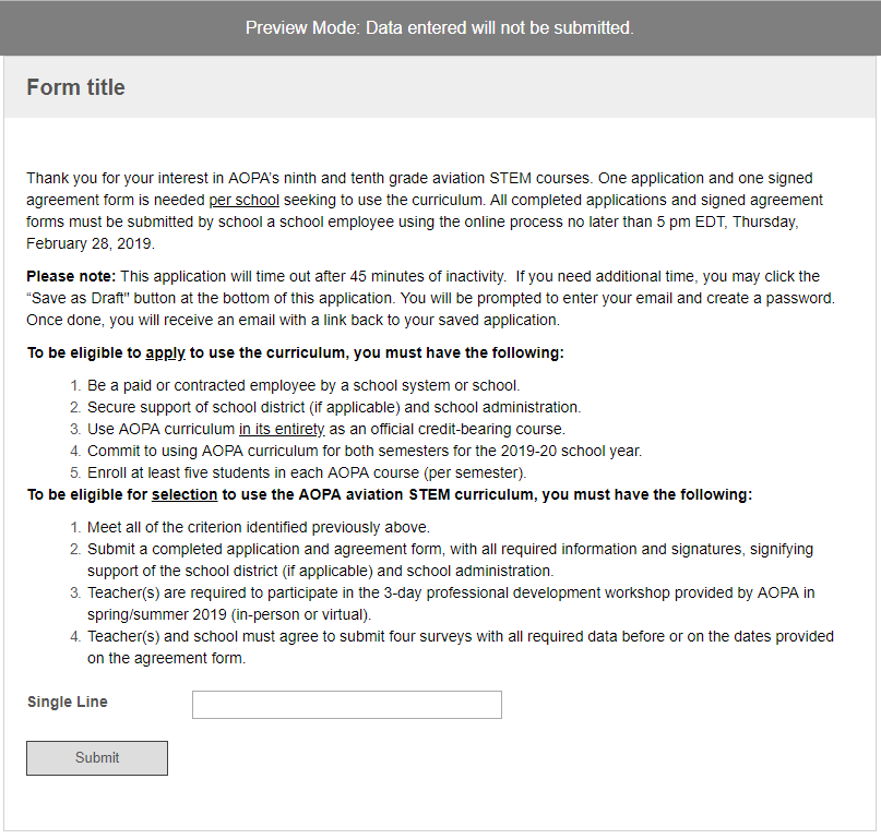

Below is the custom HTML I have. I'm also attaching the screenshot of what it's supposed to look like. I created a brand new form and copied this into it and it broke it.

After removing all custom HTML fields, it finally loads fine. I've tried multiple times of copying/pasting text back into the new HTML fields but it breaks it again. I decided to try out and online HTML editor and copied what I needed into it to get the HTML code. Still would break the form.
Only way to not break it again, is to manually type all the text back in using the form editor. So far, it's good now. Not sure what could have been breaking the form in the custom HTML box. It was just simple text.
If you want to try it on your form, below is the HTML I was using from the editor. It breaks my form when I paste it in.
<p><span style="color: #000000;">Thank you for your interest in AOPA&rsquo;s ninth and tenth grade aviation STEM courses. One application and one signed agreement form is needed&nbsp;<u>per school</u>&nbsp;seeking to use the curriculum.&nbsp;All completed applications and signed agreement forms must be submitted&nbsp;by school a school employee using the online process no later than 5 pm EDT, Thursday, February 28, 2019.</span></p>

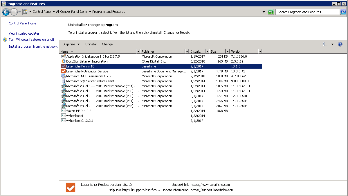

replied on March 7, 2019
Which version are you running? We are on 10.3.1.635
10.1.0 it looks like.
