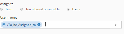

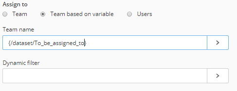

You can always create a drop down and then reference this in the Process diagram
E.g.
Dropdown within the form "To be Assigned to"
Then within the process you would refference {/dataset/To_be_assigned_to}
This would only work if you actually created a team with the exact name as in the drop down.
This can also be done for user specific but ideally you would pull a list of users using the lookup rules.
We use this for forms but we also then auto fill the dropdowns using Lookup rules so the Team or user who the forms are being assigned to are pulled from a database
