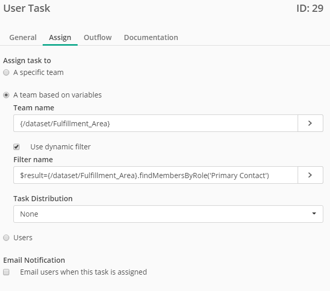

I'm struggling to configure a team-based user task based on variables using the new 10.2 functionality. I'm assigning the team name based on a variable, and trying to use the dynamic filter option, but I'm not sure what to put in the "Filter name" field.
When I use the name of a filter I created in the "Assign task to a specific team" dialog, the process returns an error "No filter could be found with the name 'Primary Contact'. [LFF6108-RuleNotFoundByName]".
When I try to use the JavaScript syntax ($result=team.findMembersByRole('Primary Contact')) in that "Filter Name" field, the process returns an error "There is no team with name ''. [LFF808-TeamNameNotFound]".

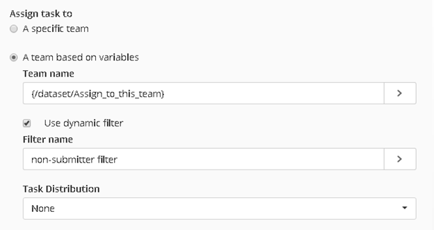

Here’s an example

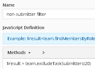

 “User Task” is assigned to a dynamic team, where team name is a field variable and filter name is a string  ”non-submitter filter”. (Note that I’ve created “non-submitter filter” in my system and I configured the field picked in “Team name” in a way that it could only have existing team as its value.
When running the process, as long as the field “{/dataset/Assign_to_this_team}” has a valid team name as its value, this task can be assigned to that team and filter (team member who is not submitter in step 20) will be applied.

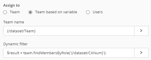

Was this issue ever resolved?  I'm bumping into exactly the same issue in Forms 10.4.4.444.  I'm selecting the team based on a variable and using a dynamic filter to pick the users but the teams have identically named roles.
Am I going to need to make sure the role names across teams are unique?
replied on June 1, 2021
The dynamic filter should be set to the filter name, not the JS method. You can use the same filter name under each team.
Filter Name: CANum Role
JS: @result = team.findMembersByRole(...)
then in the config you can put
Team Name: {/dataset/Team}
Dynamic Filter: CANum Role
You can hard code the dynamic filter to that filter name if all the teams a filter with that name.

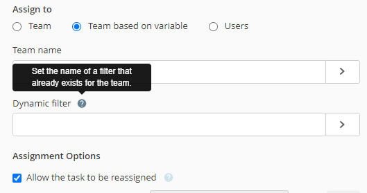

We also enhanced the UI in Forms 11 Update 3 by adding tooltip to the dynamic filter to help users understand what they should enter in the dynamic filter input

I'm working on this project with Andy. We have tried many things at this point, but I think I can give you some screenshots to get at the heart of the issue.

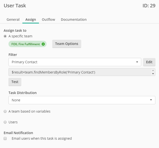

1) If you choose "A specific team" you get the filter dropdown, and you can create a new filter. This we can get to work, no problem:
2) We don't actually want to use it this way. We actually want to use the new (10.2) dynamic team assignment. So we instead choose "A team based on variables." So far, so good. Now, if we want to assign this task to a particular role within the team, which has been dynamically assigned, there is a different Filter box here. We can't figure out how to get this box to work:
We are unsure what to put in this Filter box. We have tried using the Role Name directly, inserting the javascript (copied from the working javascript on the "specific team" option) as you see above, and we have also tried creating a filter for the team using the Specific Team option, and then using that filter name "Primary Contact" as you can see in the first screenshot.
None of these options works so far. What's the correct syntax for this Filter?
