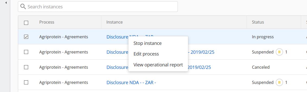

I am on the Laserfiche Forms Professional Version 10.3.1.635, and have been getting suspended Save to Repository tasks in FORMS.
It is a very basic save pdf to the repository folder. It will save one or two documents and then just start suspending the rest of the submissions.
I don't see the view error log option on my monitor screen like always.
I have made sure I have access rights in the Repository.
The strange part is that it works and stops. Please advise if anyone has come across this before or currently.
