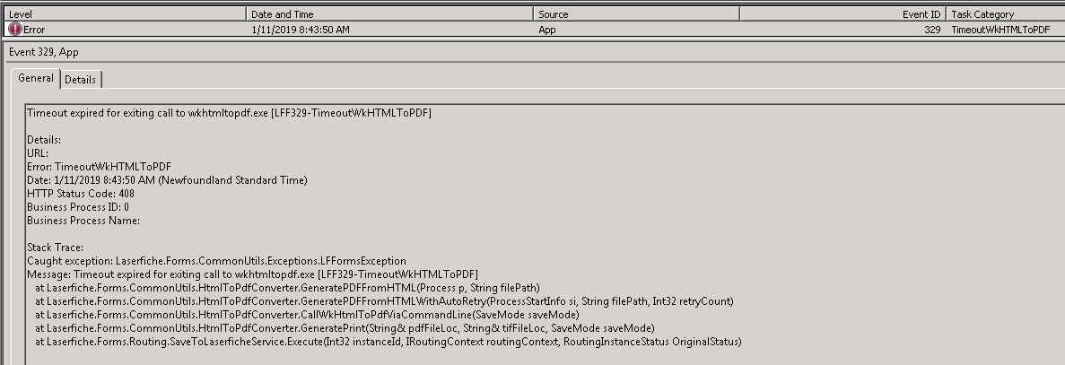

asked on January 11, 2019 Show version history
Our Forms Save to Repository processes started suspending a couple of days ago. We have upgraded to 10.3.1 hoping this would solve the issue, it did not. Timeout increase was attempted without any success.
Has anyone else experienced this? This is our third day without Forms and we desperately need this application functional. Any suggestions would be appreciated.

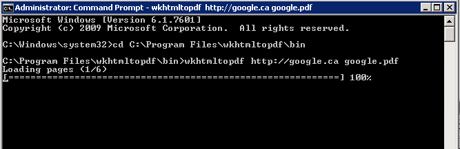

We are also unable to run wkhtmltopdf via the command prompt.

Have you tried uninstall the wkhtmltox first then reinstall it again? Upgrade to 10.3.1 won't reinstall this third party software. And your issue seems related to this third party software not working.
replied on February 15, 2019
Hi There,
I have reinstalled the application with no luck.
Any Advice on how this could be corrected?
