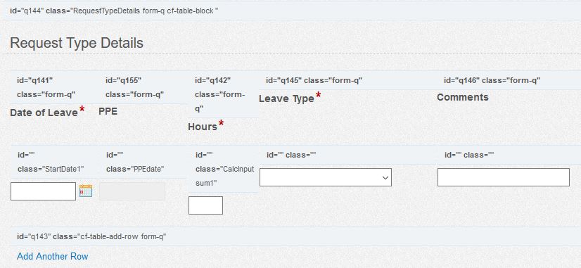

I'm trying to figure out if/how I can use the parsley validator to compare fields in a table and alert if subsequent entries DO NOT match the first entry.
In our leave request process, we need for leave request dates to all be in the same pay period. Request dates (Date of Leave) are entered in a table, and the pay period dates (PPE) are populated from a lookup. As rows are added (up to five) I'd like to find a way to alert users when additional dates entered in the table do not match the PPE of the first entry.
I've found posts here and here that use the parsley validator to look for and alert when there is a duplicate, but that's the opposite of what I want.

replied on February 25, 2019
You can use the following code, just add a "PPEtable" class to to the table and this should work as-is. I included comments to explain each piece.

However, I get the impression that you could just use functions to automatically set this value if it has to be the same anyway.
Thank you so much. Unfortunately my knowledge is not very strong so I need a little more explicit help. Could I ask you to please lay out the parts that I need to change?
This level of detail is AWESOME and I so appreciate it. I discovered that it will not work using the Forms read-only Field Option, so I am now working my way through that. Thank you again!
For the sake of clarity, if the field is read-only, under what circumstances could the value be different? For example, is it a lookup value or something else?
replied on February 26, 2019
Yes, it is a lookup value.
Another option might be to attach the validator to the field that triggers the lookup instead since it is probably editable.
That is a little bit tricker, but it is definitely possible. The error message would show there instead of on the date, but it would get around the read-only issue.
