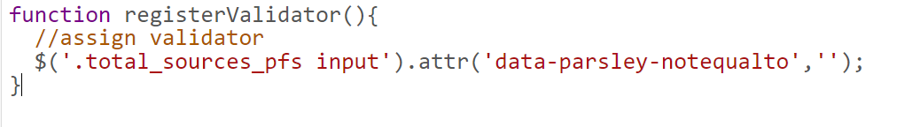

So I would modify the total_sources_pfs input within the registerValidator function?
replied on March 2, 2022 Show version history
That second part of the validator registration doesn't really do anything with a custom validator. For mine, that second part you have highlighted is always ''
The issue is the selector on the left because your selecting all inputs within the .PFSTtable class, which I assume would include every column of your table.
So what happens is that each individual column is being compared to your total, so it would be impossible for them all to pass validation unless they were all 0.
What you need to do is only target the specific column you want to match when determining whether or not it is valid.
Additionally, you should have a separate class for your "total budget" and "sources total" fields otherwise distinguishing will be a huge hassle.
Option 1 - Only assign the validator to one of your total columns and compare it to the other one.
Option 2 - Assign the validator to all of the editable columns, but return a comparison of the two totals columns rather than using the value input.
replied on March 3, 2022 Show version history
I originally wanted to select the inputs on the table because that is where the user makes changes in order to calculate the Sources Total, which matches the Total Budget. However, as long as the user can determine that the inputs contribute to the Sources Total, it should be fine to display the validation message anywhere.
Sorry I misspoke in my original post, I have a class for each total column, total_budget_pfs and total_sources_pfs .
I suppose option 2 would be the cleaner option, I tried adding the total_sources_pfs input to the registerValidator function. It is not working, I'm assuming the issue is that field is read-only?
