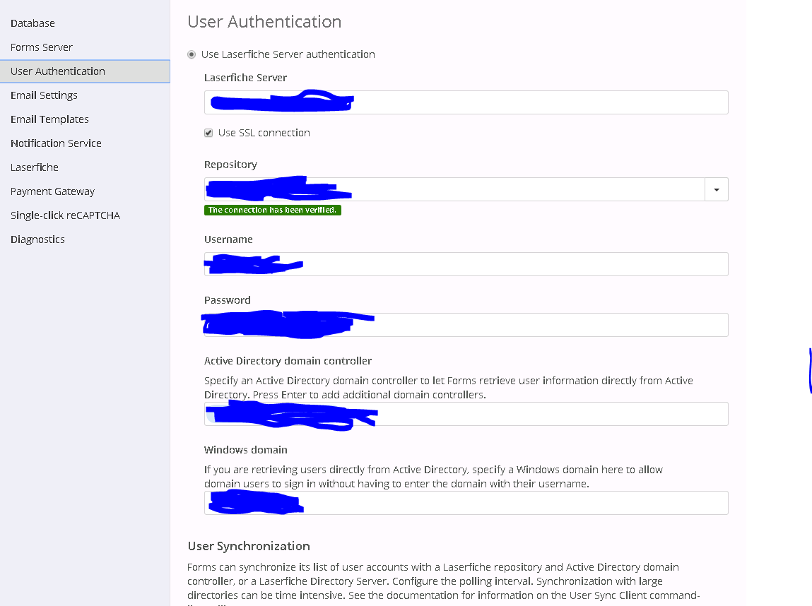

interesting.. so we are using the same forms version.. but the ONLY User authentication option is:
We do know about the cf_options hack in the db to expose the one-way option to switch( I beleive it was yourself that pointed that out to us in another, thanks again btw )
That option is what led us down the path of needing more of the windows services.. which we may end up having to do. I just wanted to exhaust this option of LF Server Authentication...
Did you have to use the cf_options database table flag change to enable LFDS option in your forms config ?
replied on February 11, 2019
Yes, if Forms is already configured then the db update is the only way to expose the LFDS authentication option.
We backed up the db beforehand as a precaution, but we didn't really have any problems with the switch. The only time it got tricky was configuring the STS page for the Forms Portal we have in the DMZ.
LF told us about the cf_options table flag, so it shouldn't be too risky. The key thing to watch out for is that you'll want a LFDS group ready to go so it will sync up your users properly.
In LFDS, we created a group called Forms, nested our AD groups inside of that, then added that group when we configured LFDS Authentication in Forms.
Yes, we did a dry run of the LFDS switch and it worked.. but had trouble configuring STS and SAML ? which I dont know much about. We rolled back the changes and and now waiting to work with our Windows team. Thanks for the import group advice, I will pass that on.
