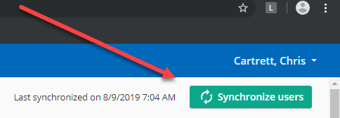

replied on August 9, 2019
Just a shot in the dark here, but have you synchronized your users:
Found in the Administration page:
You have to synchronize to see any changes made in LFDS.
Chris
