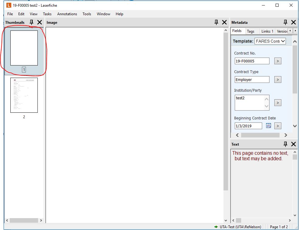

Forms action history page blank
asked on January 3, 2019
I have selected the option to include action history with the form, but it keeps saving a blank page at the beginning of my saved form. I have tried selecting both TIFF and PDF file types.
Any suggestions?
replied on January 3, 2019
It may the same bug as what is talked about on this thread. They recommend opening a support case to Laserfiche through your VAR.
What version of Laserfiche Forms are you running? I can guarantee that they will advise you to upgrade to version 10.3.2 as the first order of business :)
Looks like I am having the reverse of the issue that you linked. My version is 10.3.1.552. I will look into upgrading.
