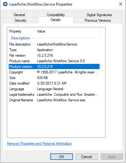

replied on November 1, 2018
it looks like the version is 10.2.0.216 (see below). However when I run the Workflow from the 10.3.1 install package it it only gives modify or repair. So do I remove and re-install??
OK... Weird issue. I also have the latest 10.2.1 Rio installation package as well. For a test I ran the Workflow installer from that and it went ahead with the update. I would expect the 10.3.1 Rio installer package to have the most recent version of Workflow services.
replied on November 2, 2018
There is a problem with the installer. Download the Avante 10.2.1 installation to get WF 10.2.1
