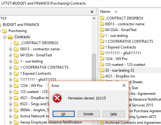

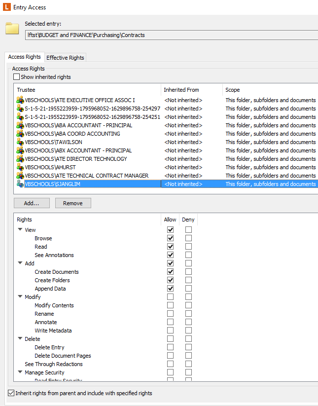

I have set the permissions for SJANGLIM (me) (attached) in Laserfiche as username Admin.

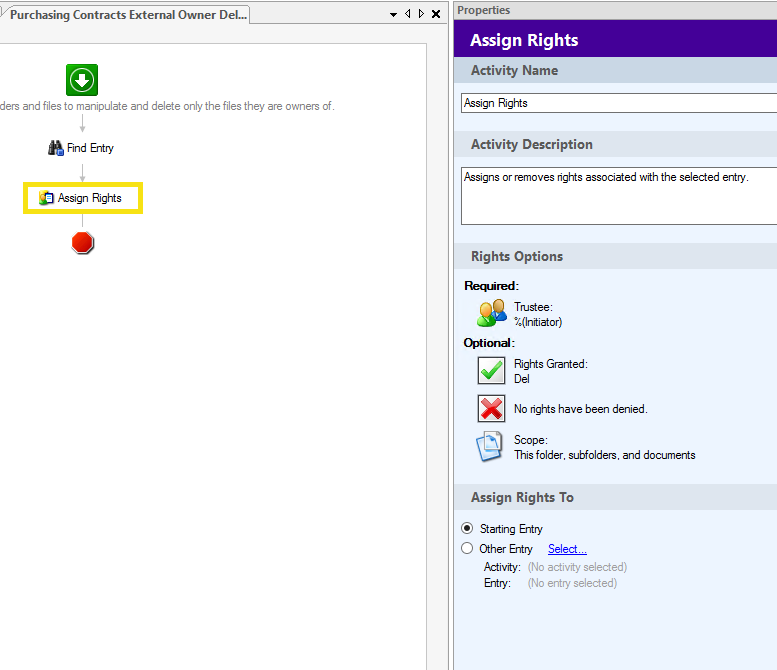

I have a workflow (attached) that just has the del allow checked for the Initiator.
When I log in as SJANGLIM not Admin I am getting an Access Denied on a file I dragged into the _Contract Dropbox which triggers a different workflow.

I would be looking at the way the workflow is set, it looks like the conditions have not been set in this instance as the "Delete" options on your user have not been checked. Which would mean you have no permissions to do what you require.
Confirm the conditions on the starting rule to make sure it is kicking off as well when needed. If you believe they have run, do a search within the workflow and find when it was run last and if it was successful as well?

>>I would be looking at the way the workflow is set, it looks like the conditions have not been set in this instance as the "Delete" options on your user have not been checked. Which would mean you have no permissions to do what you require. <<  --> I was under the impression based on what I have read on LF Answers that I am supposed to remove the Delete permissions from access rights and then allow the Delete through a workflow...  The idea is there is a group of people that have rights and to the folder.  They only want them to be able to delete folders that they are owners of.  Not be able to delete any one else's folders.

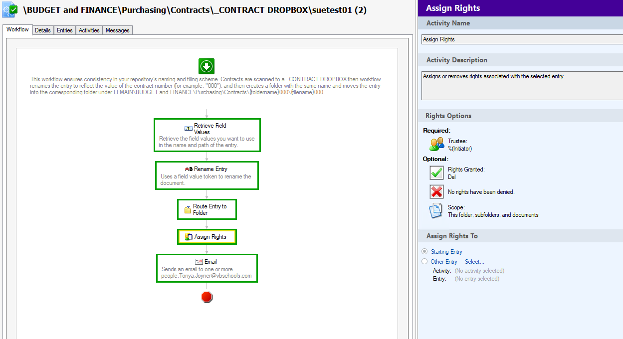

>>Confirm the conditions on the starting rule to make sure it is kicking off as well when needed. If you believe they have run, do a search within the workflow and find when it was run last and if it was successful as well?<< Thank you :) It was not firing.
I had another workflow that was firing.  So I added the Assign Rights to the workflow that was already being used and it IS triggering.  I am still unable to delete :(

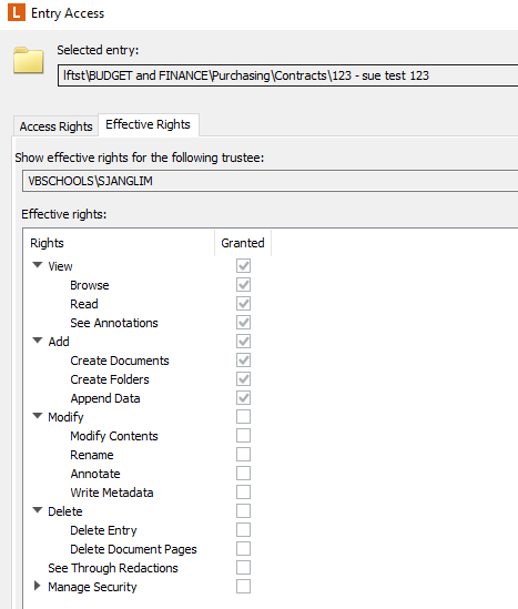

What are the effective rights on this document? Was SJANGLIM assigned the Delete feature right?
replied on October 24, 2018
Hi Miruna :)
Attached.
I will be doing this for a group.  Based on this: https://answers.laserfiche.com/questions/80470/Folder-Rights
I thought if you remove the Delete access I could add back with the assign rights to the initiator/owner.  Is the initiator the owner? :)  Maybe I shouldn't assume that.
