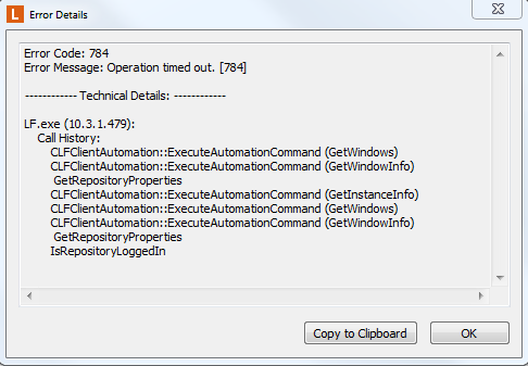

We have upgraded a couple of our users to version 10.3 (10.3.1.479).  Two of our users, if they try to pull a large report for documents that are large in size, they receive the "operation timed out [784]" error.  Below are the details for the error.  We rolled one of the clients back to 10.2 and when they pull the same search, they do not get the error.  We have a third user that has 10.3 installed and we tried running the search on their computer and they can pull it without receiving the error.  Has anyone else experienced this issue?  At first we thought it might be a "bug" in version 10.3 but since the third user can pull it fine, it is throwing us off.  Thanks!
Error Code: 784
Error Message: Operation timed out. [784]
------------ Technical Details: ------------
LF.exe (10.3.1.479):
    Call History:
        WriteOptionString ([Settings]DisplayedSearchCategories)
         SetProfileValue
          CAttachedRepository::AddProfile
           CAttachedRepository::UpdateProfile
        CFieldBrowser::TestCloseAutoSuggestHandler
        CLFClientAutomation::ExecuteAutomationCommand (GetInstanceInfo)
        IsRepositoryLoggedIn

replied on January 12, 2024
Hello,
We were encountering the same error.  Restarting the SQL Server and SQL Server Agent Services got things going again.  Not sure what caused the error, but there could be hints in what is described above as far as pulling a large report.
Hope this helps a little.
