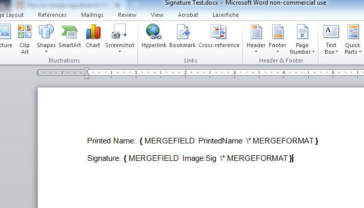

replied on August 6, 2018
In Word, Insert tab, Quick Parts/Field menu item
In the Field dialog select MergeField from the Field names list.  Type in the name of the merge field in the Field properties textbox with the prefix 'Image:'
Looks like this in Word;
Note: It would appear that the significant part of the merge field name is the Image: prefix.  If I leave that prefix off of the merge field name I get the same results as you.  Most likely a base64 representation of the signature image?
Hi Cliff,
It looks like your *.doc is different from mine. How did you add your mergefield?
4 0
Hi Cliff !!
Good Job !! It's working.
Thank you so much.
Now I need to know how to reduce this pictures... its a little too big XD
