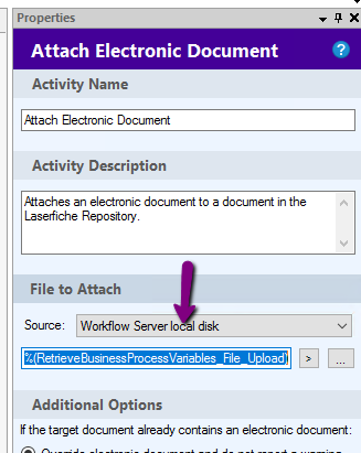

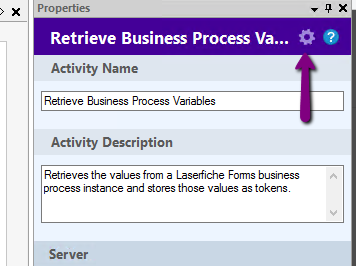

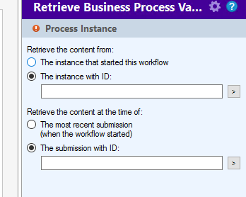

You would need the instance and submission IDs of those forms. Workflow could retrieve the data and use Create Entry and Attach Electronic Document to save it to Laserfiche.
replied on May 21, 2018
Thanks Miruna. Is it possible to Attach Electronic Document from the file upload variable value in the form (i.e., in the format of 585:\9c3df41a-dbb8-4eb8-8d11-fb32188bd20b\RetrieveBusinessProcessVariables\8603\15350.pdf ). If so, how is that done? I'm searching for that file on my servers but cannot find it.
replied on May 22, 2018
If you set the Attach Electronic Document activity to use files from the server's local disk, then you can use the token generated by Retrieve Business Process Variables for the upload field to specify the file location.

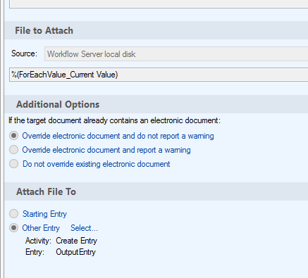

I added a For Each File loop using the file upload Variable name as the File Collection. It went one step further and gave me the file name (in its basic form, e.g., myfile.pdf) with no path or anything. But then I get the message "The File 'myfile.pdf' cann not be found. [0453-WF1]"
Hello again,
Somehow that long file name and path came back and so I am iterating through the file upload value to get the value (in case there is more than one). I see it populating the variable with that path/file value but then I get an error. See below. Any ideas would be great.
