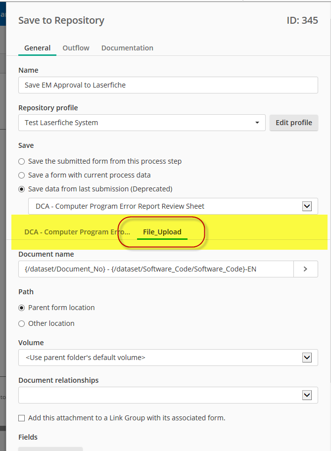

We have Ver. 10 Forms in our test system. Getting strange behaviors. Just wonder if this is typical. We converted many Forms business processes. I am having issues with Save to Repository. I open it to edit it, and it's fine:

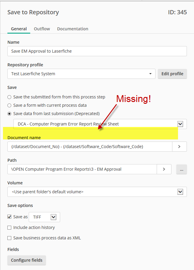

I save my process and go back in to edit the same Save to LF and get:
Anyone else experience this strange behavior? I can do F5 to refresh, but that's time consuming for these big processes I have. Oh, and I have also had to create all my "File_Upload" metadata since going from Ver. 9.2 to 10.2.

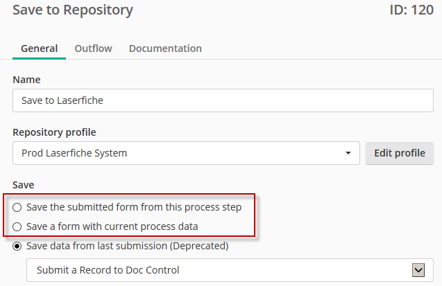

@████████, I'm so glad you mentioned what you did! It solved my issues! I took a very complex process (has at least 6 Save to Repository tasks) and changed them all to "Save a form with current process data". Not only did I NOT lose the file upload tab but I was able to jump from each of those tasks and never had an issue. Every time I opened the a Save to Repository task, my file upload tab was there and I was able to make changes, save, and open another. It's the "deprecated" one that is broken and reeking havoc! Just so you know, it's the "deprecated" option that disappears and never comes back. I'm OK with that! (Refer to https://answers.laserfiche.com/questions/89547/Save-Data-From-Last-Submission-Deprecated#89548.)

I do have a file upload on my form. That's why when I press F5, it suddenly appears, as I wish it to. Never had this problem in Ver. 9.2. BTW, I'm reporting to my VAR as well.

It shows up initially. I get out and either go to the same Save to LF or another Save to LF task within the same process and it has disappeared. When I refresh, it reappears, but again, I get out and either go to the same or another Save to LF and it disappears. I have to save the process and refresh each time I want to edit a Save to LF task.

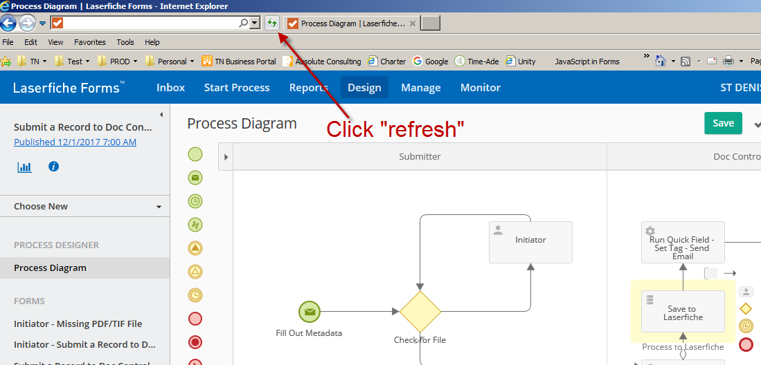

Gloria, when you say you "refresh", what exactly are you doing?

My advice to you is to keep that (Deprecated) option selected on the Save area (i.e., never choose any other option and save). Once you save an option other than (Deprecated), then that (Deprecated) option disappears altogether. I believe that is when you will permanently lose the file upload tab.

When I "refresh", I click the IE refresh:
Reread your email: All my saves are set to "deprecated":
I'm going to try the other two just for giggles once my test system is back up and running later today. Will let you know if the same thing happens to me!
