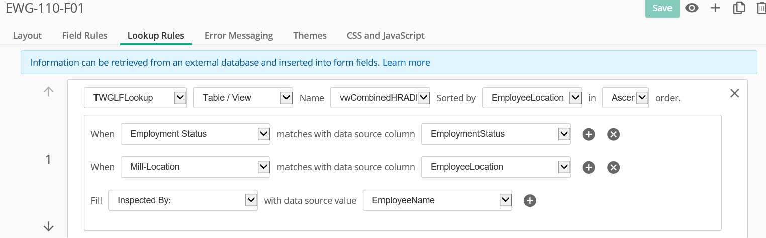

I have forms using a SQL view that have a rule set to look for employment status and location to fill the inspected field with a list of names from the view.  This has been working fine for months until last week when the AutoFill field stopped appearing and there was no content from the lookup.
Prior exchanges regarding the AutoFill not appearing on copied forms (for version 10.2 https://answers.laserfiche.com/questions/127311/Lookup-Rules-Dont-Work-on-Copied-Form#repliestomain) indicated that deleting and recreating the rule would correct the issue, but this is not the case.  I can't get the inspected field to fill with the secondary criteria of location, but when I remove it and only have a single criteria it fills.  (Doesn't limit my list by the location obviously, but I can at least provide names for selection by the users.)
Why would this start to fail now?  I have not updated to 10.2.1 update 2 yet, but this was working fine until now.  I've refreshed the data source multiple times but it doesn't seem to be working.  It's also showing up on other forms that have multiple criteria for lookups, so this is wider spread than one form.

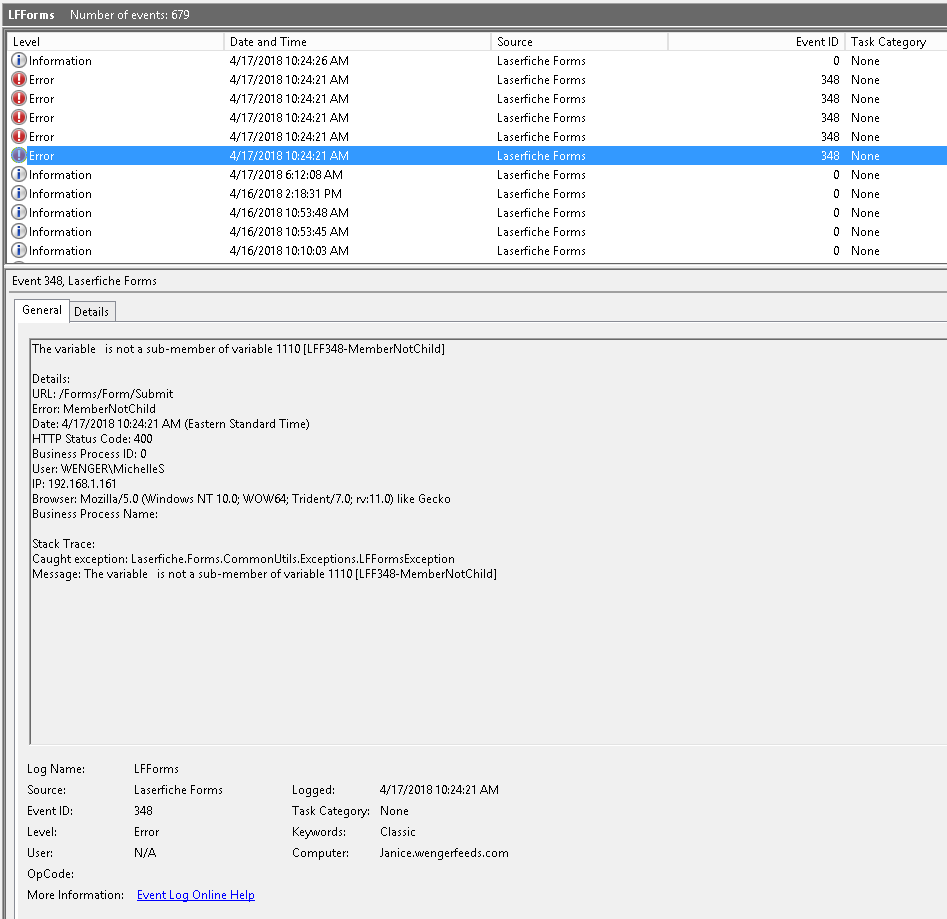

replied on April 18, 2018 • Show version history
I checked the event viewer and the only errors I found related to the time I was experiencing the error are those indicated in the screen shot.
I recreated the rules two times for two of the forms.  The others I left with the original rules which, when I went back in yesterday were still not working until I deleted them and recreated them.
