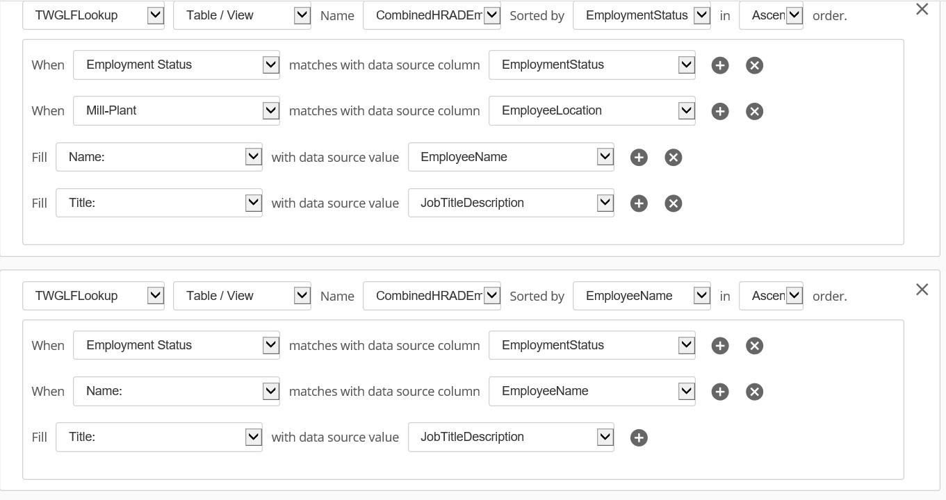

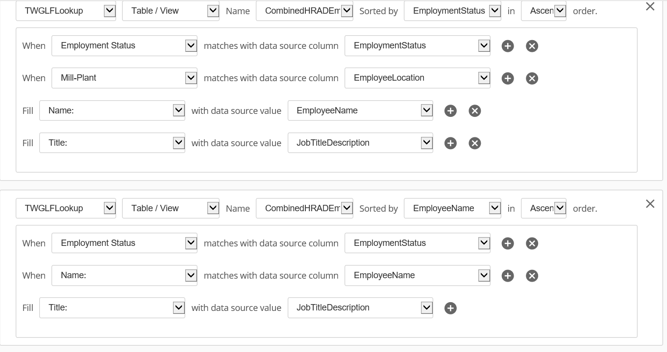

Has anyone else experienced lookup rules not working after copying a form?  I have a weekly form that has much the same content as its monthly counterpart.  So I copied the weekly, made changes to the form name, process name, and form title to reflect the monthly status.  Then I removed several fields that had field rules but no lookup rules.  With the form base now set for the addition of other monthly fields, I went to test the lookups in preview and found that only one of my four lookups worked.
The lookup that works only has one WHEN condition.  The others have two WHEN conditions.  Deleting the first rule with the dual condition and recreating it fixed the other lookups, but why did they stop working in the first place?
Thoughts?

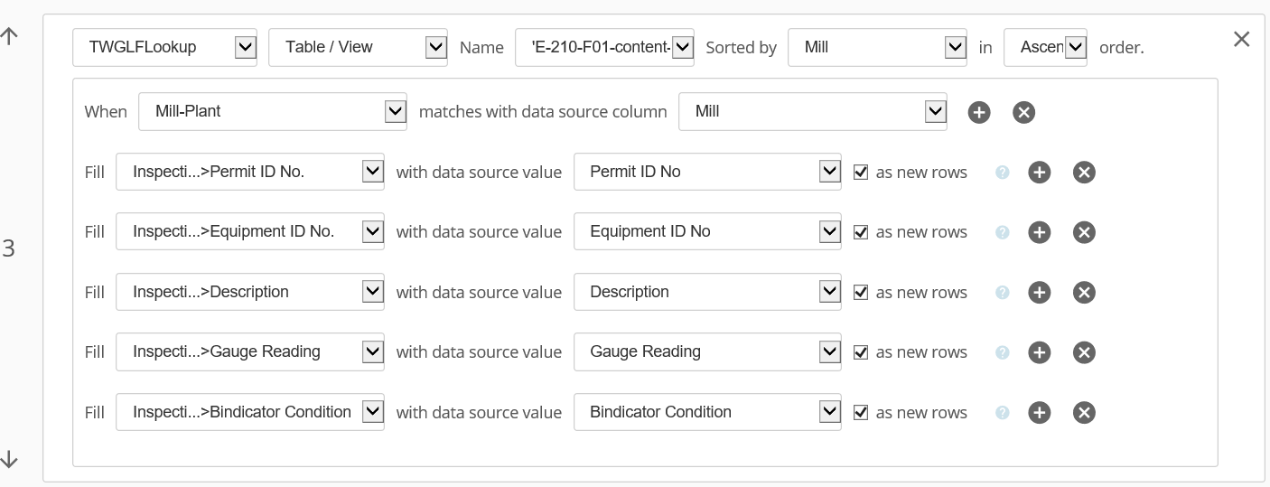

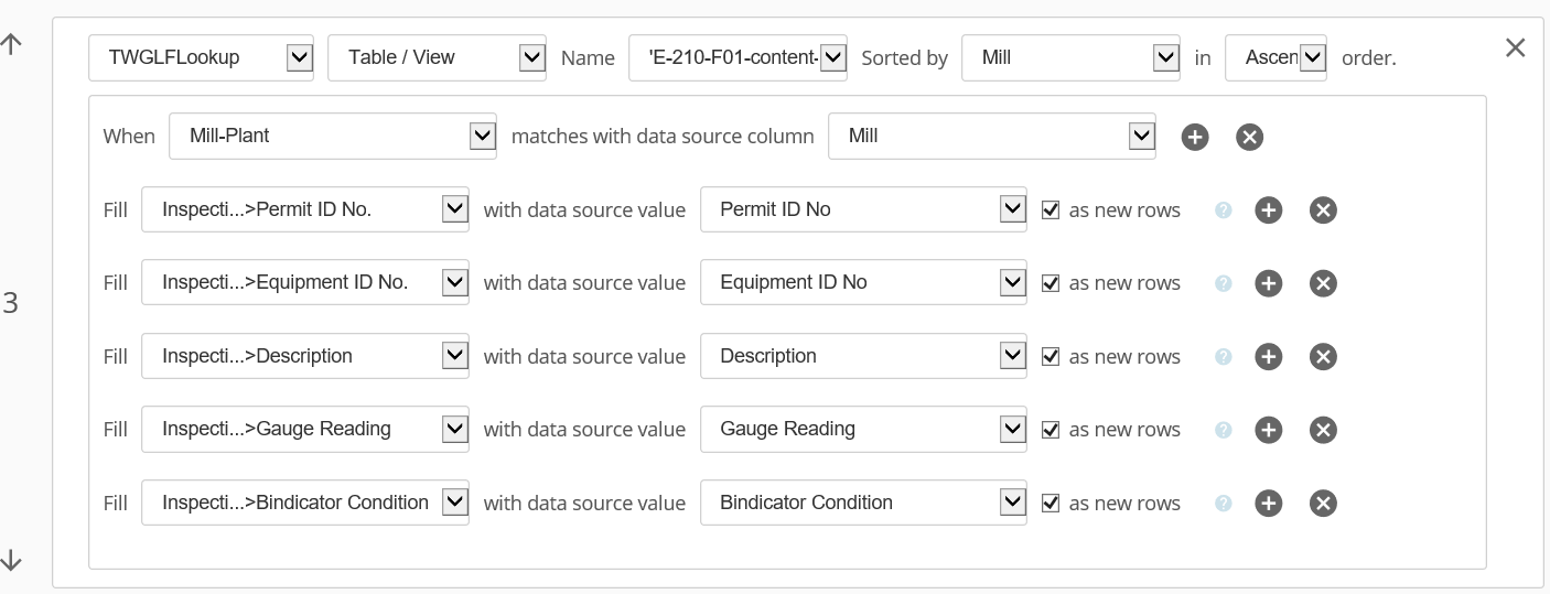

Rui,  Yes, I copied the process from the manage page.  Using Forms version 10.2.0.789.
Fields being filled by look up are single line text fields.  The first and second lookup rules were not firing, but the third (which filled a table) was.
