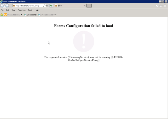

I just completed an upgrade of an Avante client from 10.2.1 to 10.3 and everything went fine until we upgraded Forms and attempted to access their FormsConfig page. We receive the following error: The requested service (ILicensingService) may not be running. [LFF3004-UnableToOpenServiceProxy]
I verified that the Forms Routing Service was started. I tried stopping the service and restarting it. I attempted to change the login information for the service. I redid the license manually. I even tried using different browsers and nothing seemed to work.
Has anyone seen something like this before? It almost seems like there may be a port conflict but I'm unsure.

replied on February 21, 2018
Hi Brian,
After you stop/start the routing service, can you check the event log Laserfiche -> Forms -> App -> Operational and see if there is log like:
Licensing WCF service stopped successfully.
Function: Routing engine onStop evt
Licensing WCF service started successfully.
Function: Routing engine onStart evt
Or is there any error related with starting routing service?

replied on February 22, 2018
Yes, we're getting few of those reported on the event logs. Do you know what its indicating?
These logs mean that Routing service licensing thread has stopped/started successfully, so the error you have seen should not happen.
If the licensing service has started successfully but you still saw the error, can you open a support case for the issue? Thanks.
