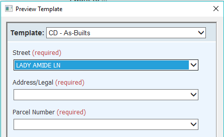

This thread indicates that result choices will narrow based on what has been typed into a dynamic field, but this feature is not working for me.  I don't get an error message, but when I begin typing in the field, the first value that begins with the first letter I typed in appears in the field.  In this example, I typed "L" in the STREET field:
This is not working as described in the referenced thread.  I'm wondering if this feature is just no longer available?

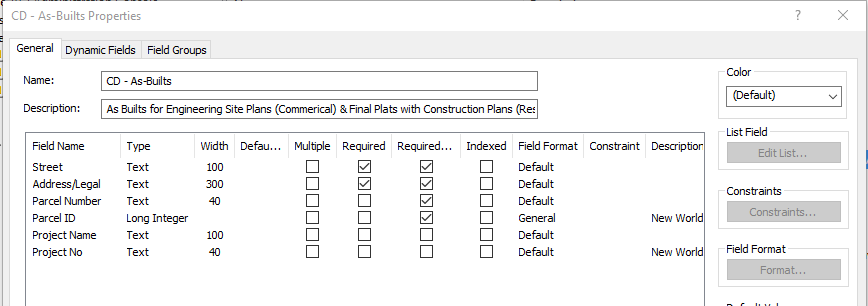

Here is my template setup:

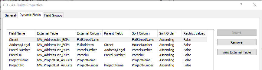

GENERAL TAB
DYNAMIC FIELDS TAB

Hi Laura,
I suspect this is working, just not as you expect.
If you just type an 'L' into the street field you will get the first L value from your table, just as you see.   You can then select the L street from the drop down list.
OR if you keep typing (rather quickly) the first few letters of the street name it will start to narrow down the choices, to the point the street name is unique in the list.
Once you have a unique street name the rest should fill in.   Unless there is more than one address/legal entry for that street in your database.  At that point you again need to specify (or type) in the address/legal field.
Basically you need to keep specifying information until there is a unique entry in the database, at which point the remaining fields will fill in.
For example on our HR template,  if I type S into the last name field, I get the first entry Saade.  If I type Saxton the rest of the fields fill in since there is only one Saxton.    If I were to type Smith, I would then have to move to the first name field and select which Smith, since we have multiple Smiths.
The setup you posted looks as if it should be working, possible there is an issue but hard to know without seeing your tables.
