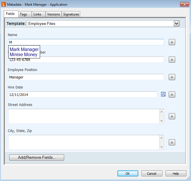

I assume by intellisense you are referring to the auto-completion of the field while a user is typing? You can do this with either list fields or dynamic fields. Here is an example:
The Name field shown above lists any options that begin with the letters typed in. From there, the user just has to select which name they were attempting to typing in. This is possible as long as the field has a list of values to pull from, namely either list values or a database table.
One thing to note: you can determine how many options are listed in the drop down by setting the attribute:
[Settings]MaxDropDownLength
If you still see the complete drop down list instead of a few values that pop up as you type, you will need to lower the value of the attribute.
