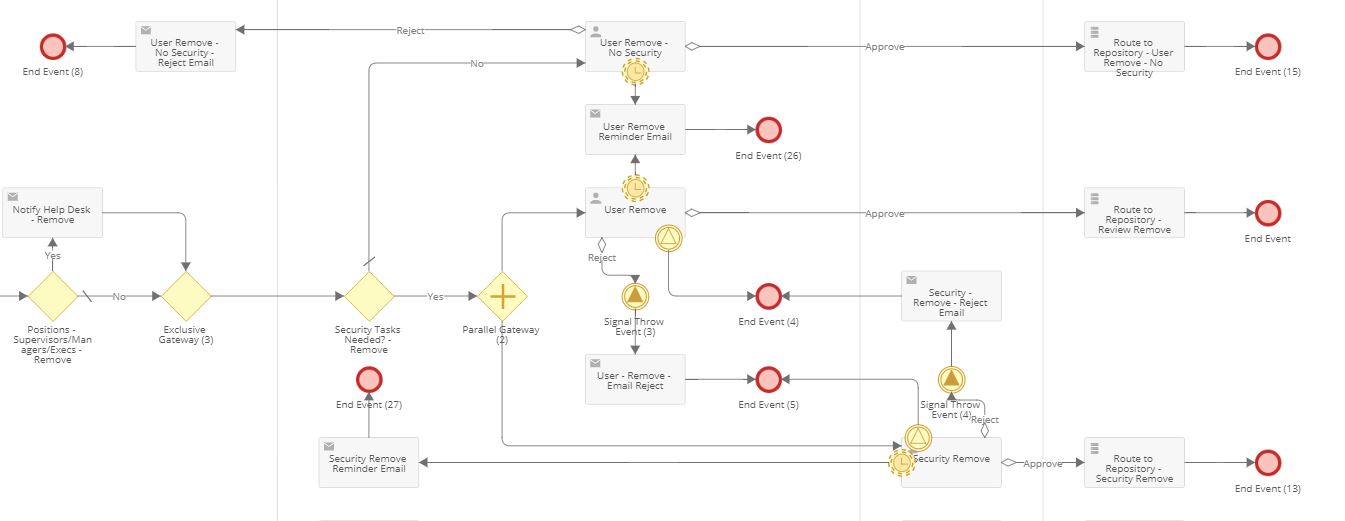

Here is a screenshot of the removal branch, which is the only branch to be based on the every 5 day interval.  The other branches are going every day.
