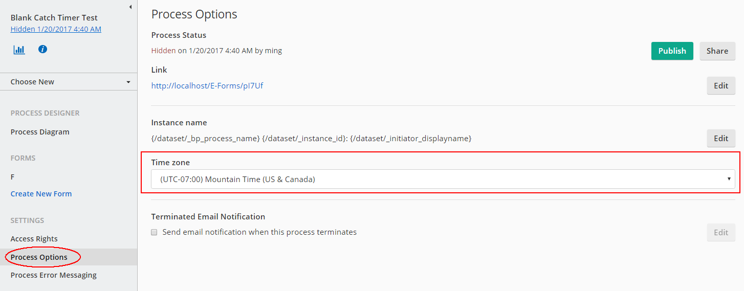

Can you try and check whether the Process TimeZone setting matches your local timezone? The timer events should follow the process timezone.
If you are using Forms 10.1, click the hamburger button on the left of Process Diagram. On the menu, click Publishing Options.
Check the timezone whether it is the same as your local time.
If you are using Forms 10.2, the options should be on the left drawer of the Process Diagram.
Let me know how it goes.
replied on January 19, 2017
Thank you for the reply @████████
Yes, it is showing my local time:
