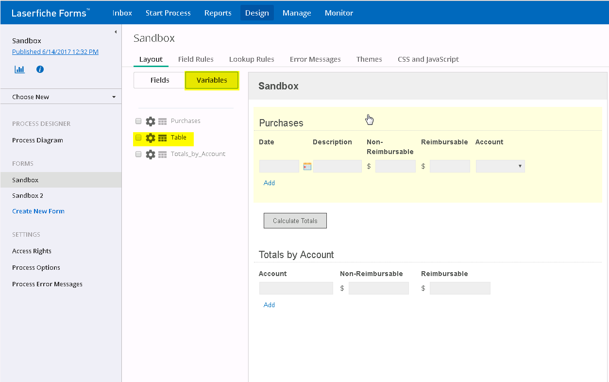

If I understand your request correctly (sounds like you want field values to persist across the various forms used within the process), you should be able to accomplish what you want by making use of the processes's "Variables", found in the Layout tab for a given form. For example:
Notice how the variable named "Table" appears in boldface--that means it's not included on the "Sandbox" form, though it can be dragged-and-dropped onto the "Sandbox" form--doing so will add it to the form and when the form is assigned to a user task in the process diagram, it will contain whatever values were entered into it in a previous step(s).
TL;DR If you have a field named "Field 1" on "Form 1" that gets populated at some point, you can pull it into "Form 2" for use in a later step by dragging and dropping the variable "Field 1" onto "Form 2".
I hope that helps!
~Rob
replied on July 25, 2017
That should help a bunch and ironically I had just run across this solution as you responded. Thanks for your help and confirmation that this method should work great!
