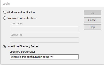

Hi All,
How do you update the LFDSSTS URL for the thick client? I can't find where it's set?
Cheers!
