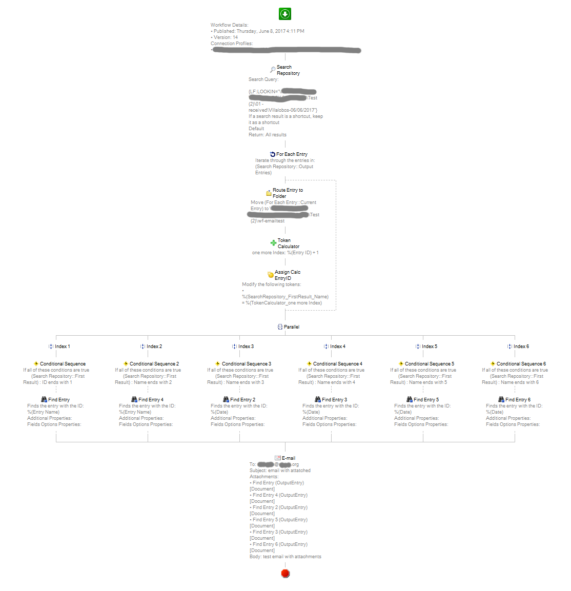

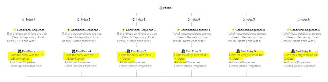

Created a workflow for attaching multiple documents to an email in workflow.  The WF runs, and sends the email, however, it does not attach the expected files to the email.  What is incorrect in the workflow?
replied on June 16, 2017 • Show version history
Have you checked the results of the workflow? From the look of the Find Entry activities it seems like they are not getting valid Entry ID's and therefore won't find the document.
You're using %(Entry Name) and %(Date) tokens where you should be putting an Entry ID value. The %(Entry Name) is referencing the string name of the Starting Entry, which is very unlikely to be the ID value you are trying to get, and the Date definitely won't be a valid entry ID value.
I'm a bit confused by some of the activity configuration you have in there, so I'm not sure exactly what is supposed to be happening in the workflow. I don't see any way for your workflow to attach more than one document to the outgoing email.
For example, despite the parallel branches, there's no way the "first result name" could end with both 1 and 2, so there's no condition in which you would have more than one document to attach even if you get the correct Entry ID in each of the Find Entry activities.

Ah, sorry... I see your confusion.  I started playing with different values for the Find Entry to see what I might be configuring incorrectly.  Sorry for the confusion...

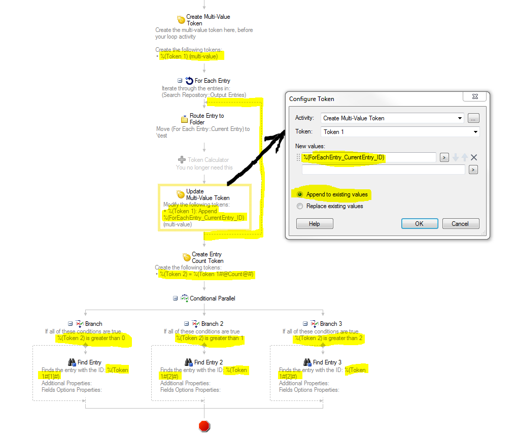

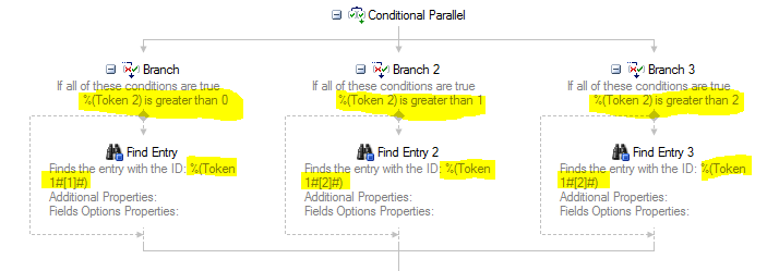

It looks like you are using the solution from this post. If so, then you should be using a multi-value token to store each of the entry IDs. The following process should work and be less dependent on regular expressions.
  • Create multi-value token for "Entries"
  • For each entry
    • Route Entry
    • Append %(ForEachEntry_CurrentEntry_ID) to "Entries" token
  • Create/Assign "EntryCount" token with %(Entries#@Count@#), use Count or Integer tag

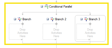

  • Parallel Branches
    • Branch 1
      • IF "EntryCount" token > 0
      • Find Entry by ID - %(Entries#[1]#)
    • Branch 2
      • IF "EntryCount" token > 1
      • Find Entry by ID - %(Entries#[2]#)
    • Branch 3
      • IF "EntryCount" token > 2
      • Find Entry by ID - %(Entries#[3]#)
    • etc.

Am I on the right track or have I gone off the rails...?
It looks like you're getting closer, but you need to make a couple of changes. First, you should be creating the multi-value token before the "for each entry" loop, then you append another value each time the loop completes.
Remember the for each entry is a loop, so you add the "current entry: entry id" with each iteration, you can't add them all at once like that. Also, unless I'm misunderstanding your goals, the Conditional Parallel needs to be outside of the for each entry loop, more like in the following image:
EDIT: Branch 3 should have %(Token 1#[3]#)

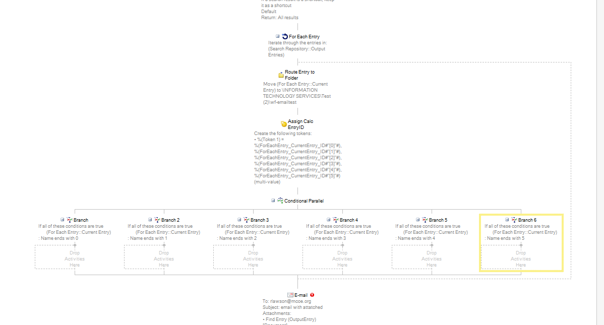

I'm still a bit confused why you are evaluating the name of the "For Each Entry: Current Entry" in your conditions.
replied on July 12, 2017 • Show version history

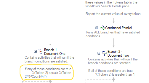

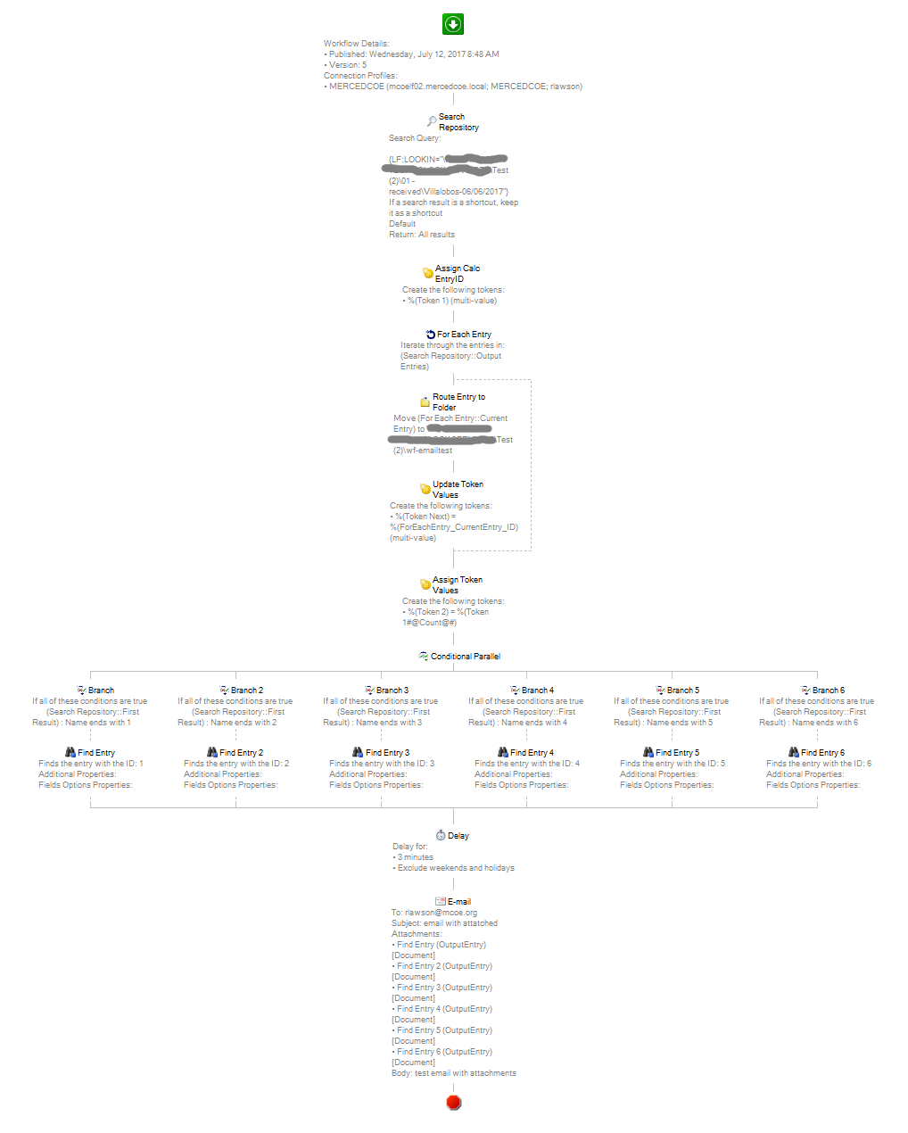

okay so I'm back to testing this workflow.  I made mods based on the graphic you included.  However, I'm still not able to get attachments.
I have included the wf as it stands now, below.  Your thoughts would be appreciated.

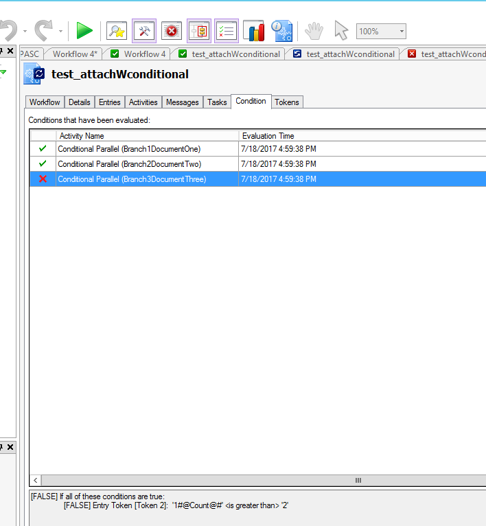

I'm still seeing the same issues with your conditional parallel and the Find Entry activities contained within the branches. The conditions are still looking at the Name of the first search result, so it would never hit more than one and isn't looking for the correct condition.
You will need to update the conditions to match the ones I had in the example; it should be looking at the count token (Token 2 in your screenshot) to determine how many files are available to attach.
If the count is 2, you would hit branches 1 and 2, if the count is 3, you hit branches 1, 2, and 3, and so on.
Additionally, after that is fixed, your Find Entry activities are set to find entries based on static values, not tokens. For example, the first branch looks for an entry with the ID of 1, so even if it hit that branch it would always return the same entry.
To correct that, you should be using "Token 1" where you are storing the Entry IDs, and using token formatting to set the Index of which item to retrieve. Index 1 for branch 1, Index 2 for branch 2, etc.
You should also be checking the Condition results and Token values after the workflow runs to make sure everything is being evaluated and tracked correctly. Those tabs will go a long way to helping troubleshoot and figure out exactly what part of the workflow is causing issues.
I'm currently using 10.2, but I've used this same workflow configuration at least as far back as 10.0, and the activities we're using here should still work the same even in a 9.X version.

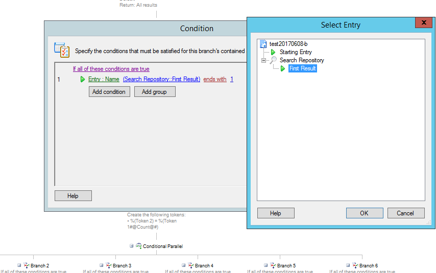

Again, I'm trying to understand why you are setting up the condition that way.
With the setup shown here, it is looking to see if the Name of the First Result ends with a 1, and I don't understand the motivation behind that setup.
The only way that would evaluate to True is if the first result of your search was Named, "name1" or something along those lines.

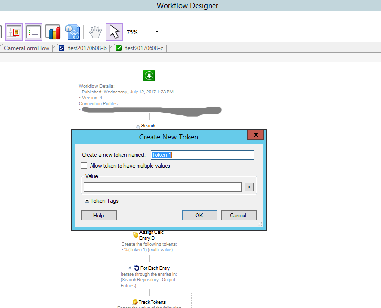

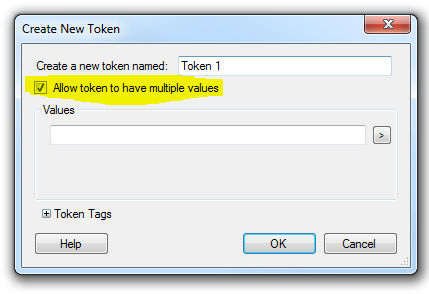

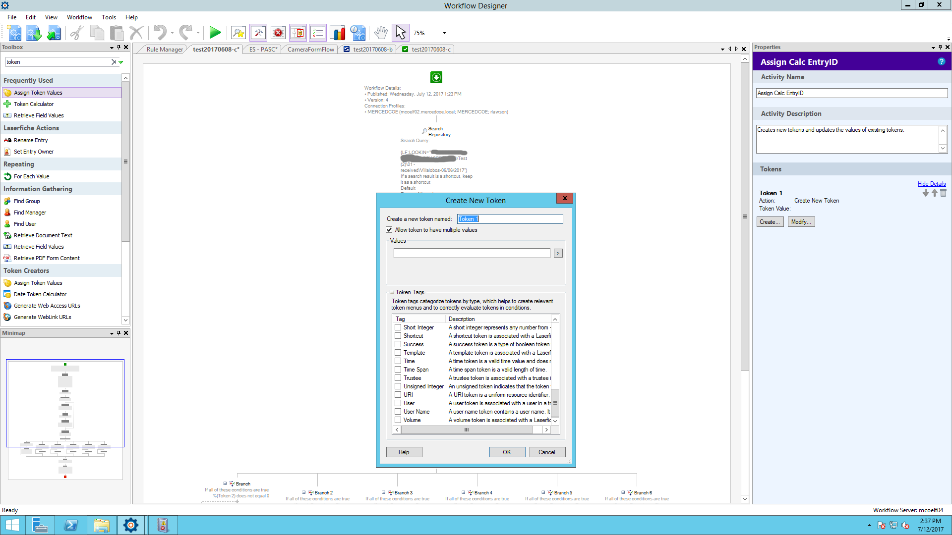

I only asked because I don't have the append to token value check box when I create a token under 9.2

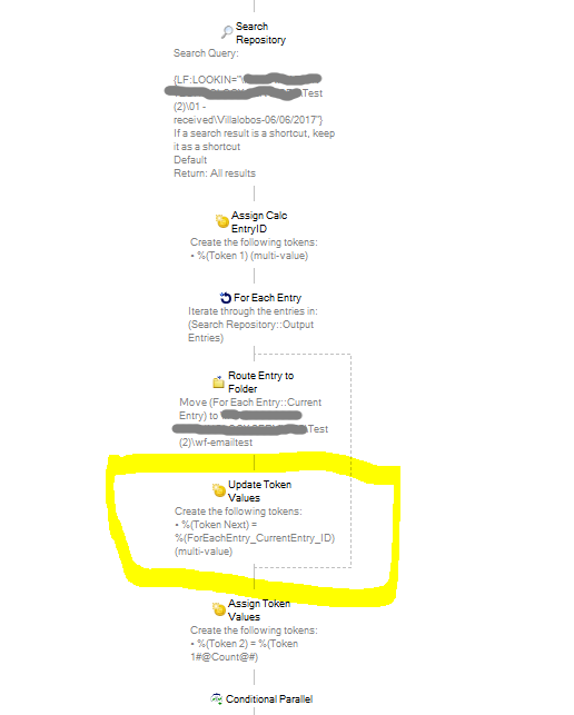

Can you attach a screen shot of the activity that creates the token? You need to mark it as a "multi-value" token to enable that functionality and 9.2 should have the same capability.

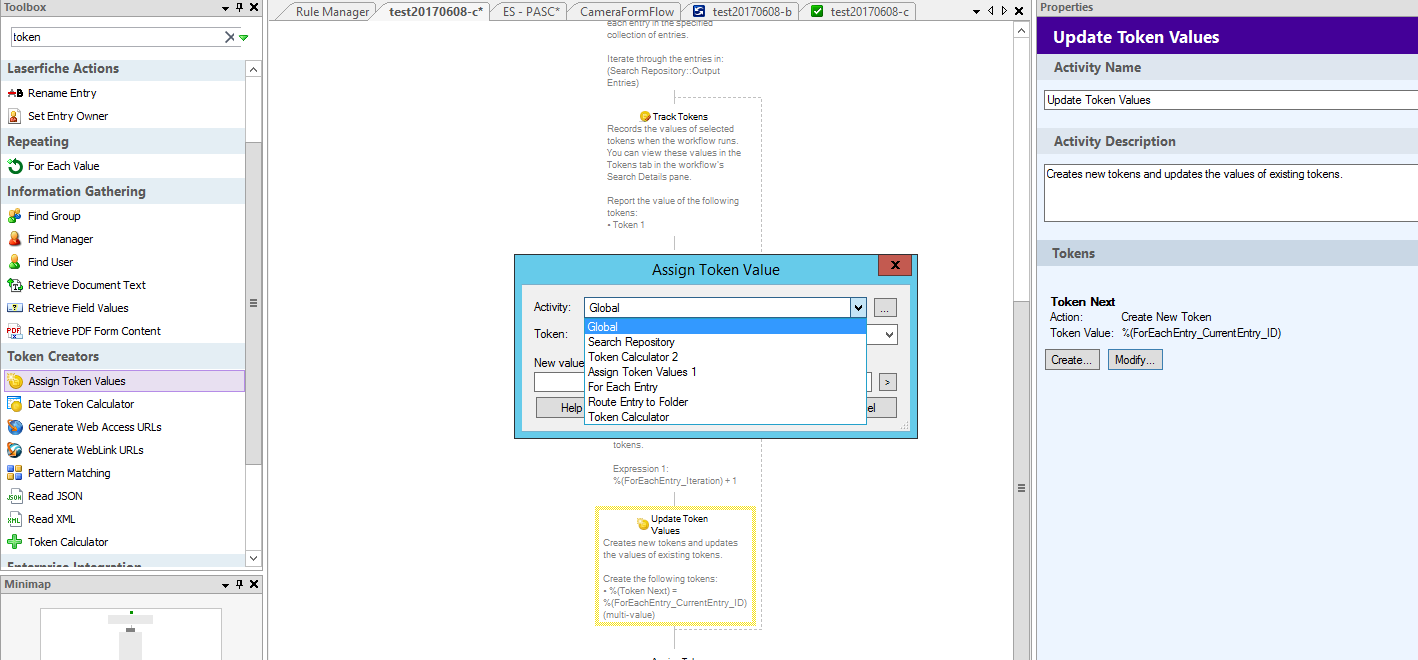

attached token ativity
Your "Update Token Values" activity is not "updating" Token 1, it is "creating" a new token named "Token Next"
You have to Modify the existing multi-value token to have the Append option. Currently it is just creating a new token each time it goes through the loop.
attached is a brand new token creation... I don't see where I have the append option...
That is the problem, you're selecting "Create" token, but you need to select Modify to be able to append values to the existing token you already created at the start of the workflow.
Create makes an entirely new token
Modify updates/adds values for an existing token

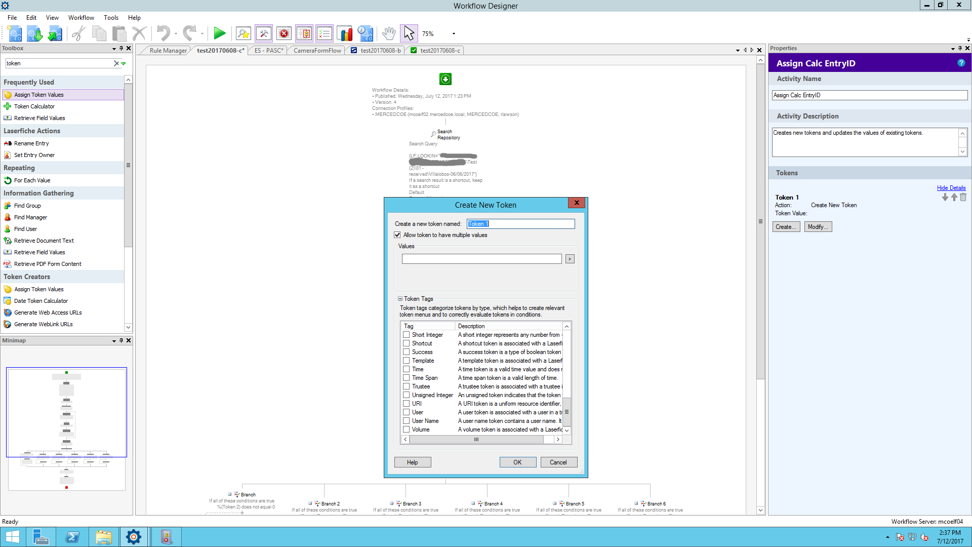

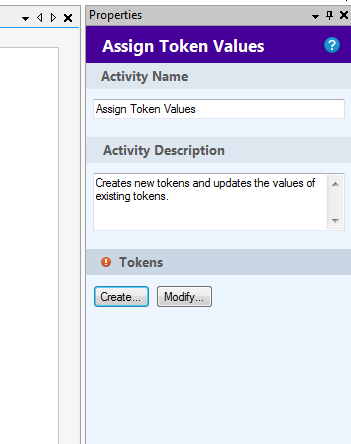

I'm sorry i'm missing it... I just don't see where I can add or activate these options...
These options are displayed in the Properties pane when you highlight a token activity (Ctrl + 4) or View > Properties.
If you're just double-clicking the activity it will only give you the option to create new token, not Modify a token.

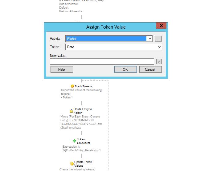

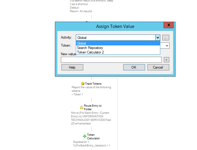

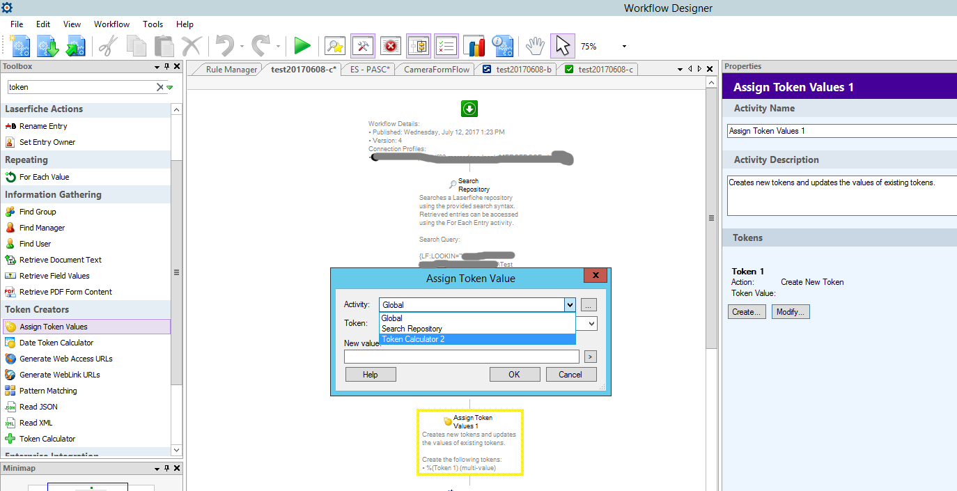

I understand that part.  tokens2 and tokens3 are what appears when I click Modify from the properties pane.
Which activity specifically is selected in those screenshots?
Can you get a screenshot that includes the full properties pane, the highlighted activity, and the "activities" list (like the Token 2 image) all in view with "Update Token Activities" selected/highlighted, all in the same view.
The screenshot is showing a "Token Calculator 2" activity as an option and I don't see that anywhere in your workflow.

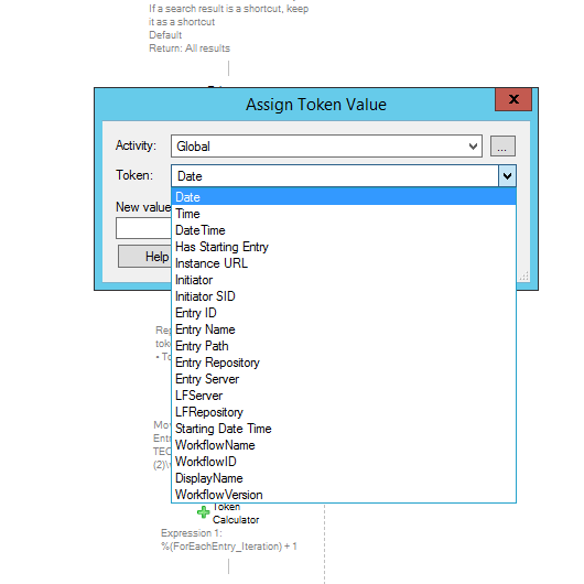

replied on July 13, 2017
the image is of 'Assign Token Values' task with the 'Assign Token Value' which appears when 'Modify' is clicked in the properties pane to the left.
replied on July 13, 2017 • Show version history
You're not selecting the right activity, the one you have highlight is the one where you first created Token 1, you need to select the one that appears within the loop.
token task from 'for each entry' loop.
Now we're getting somewhere! smiley
Select "Assign Token Values 1" as the Activity, then select your multi-value token from the Token drop down.
done.
With that selected it should give you the "Append" option as long as you chose a multi-value token. If that's not an option, please send a screenshot.

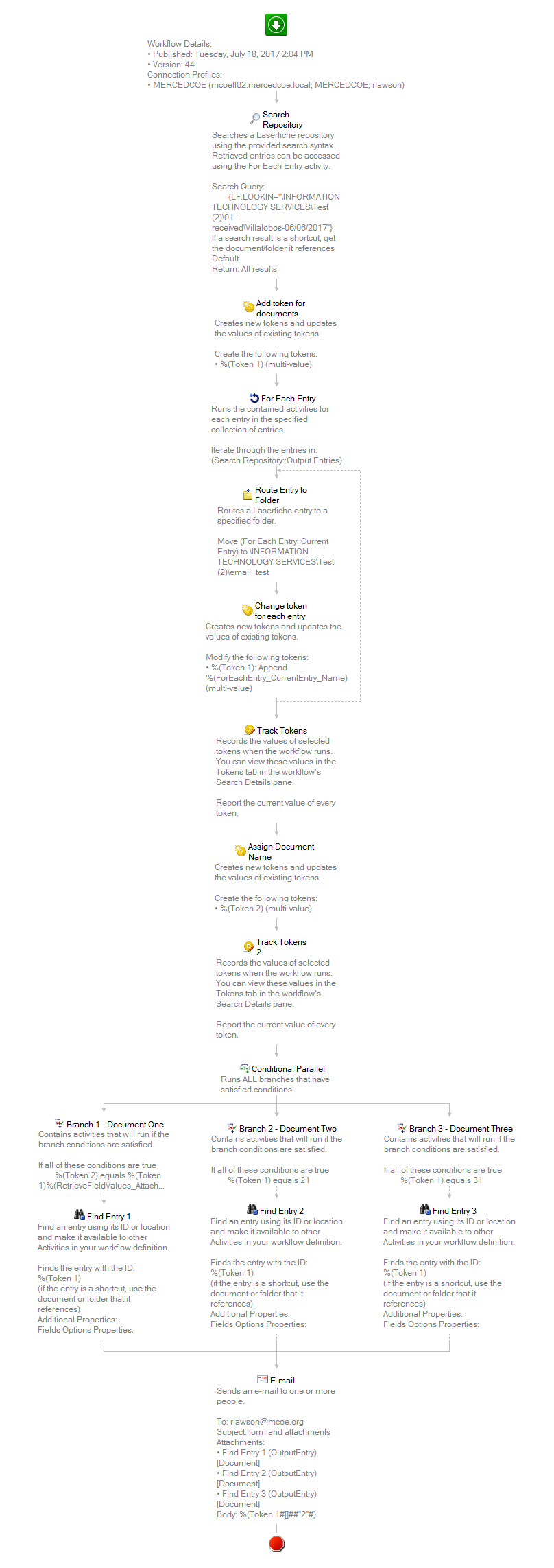

replied on July 14, 2017

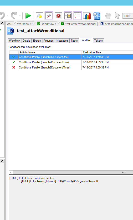

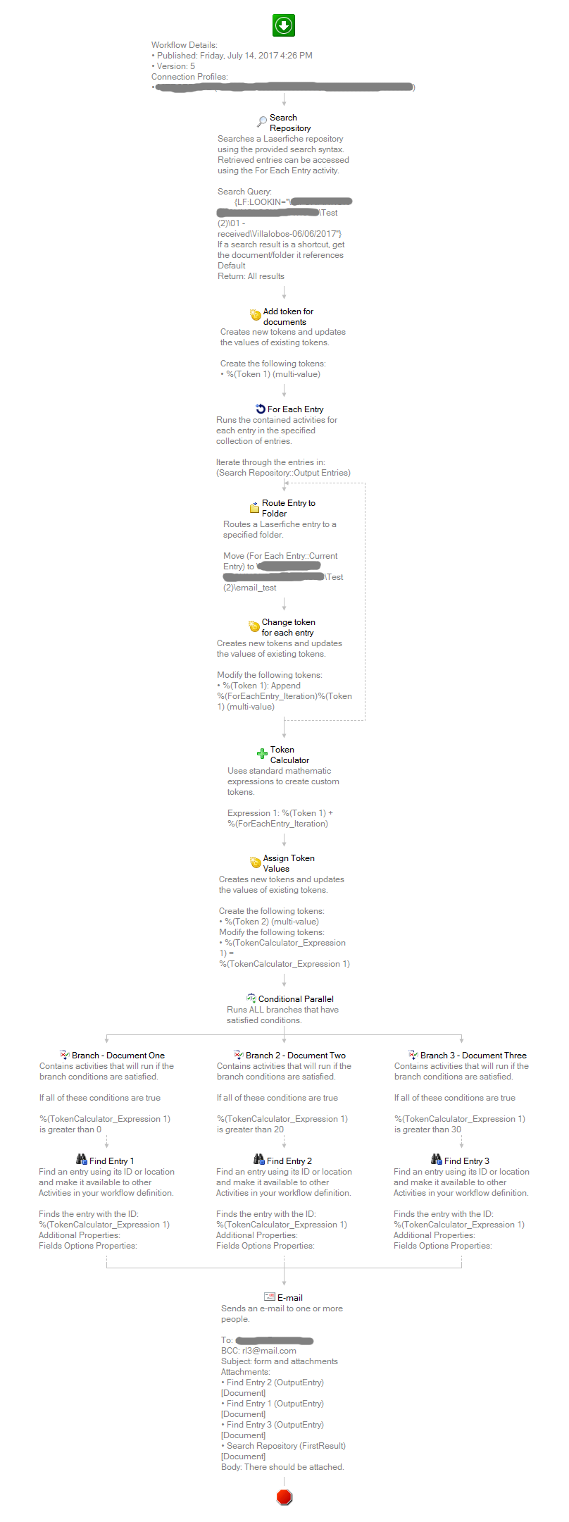

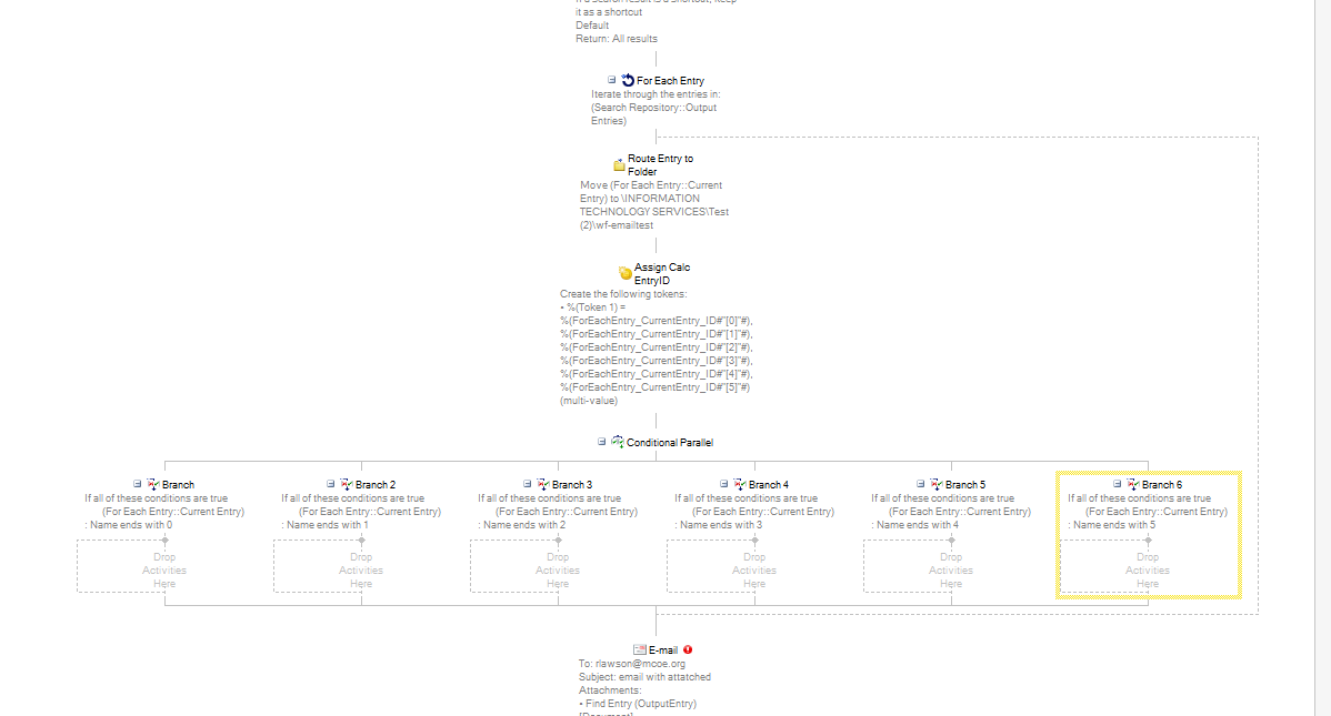

so I cleaned up my wf.  hopefully it makes more sense.
I didn't add all the branches to keep down the clutter.  I am still unable to get ALL of the attachments.  I included the email because I am getting a .lfe shortcut but I don't know why.
any thoughts?

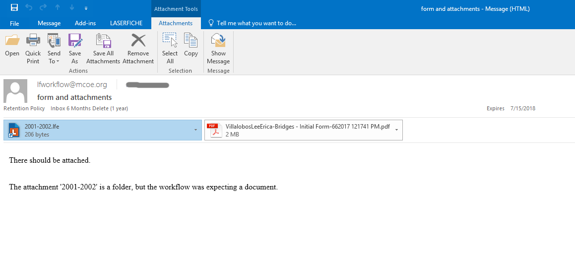

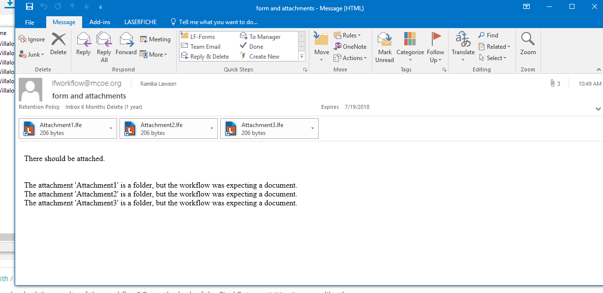

It looks like you need to modify your search to only include documents, or check whether or not the CurrentEntry is a document before adding it to your multi-value token/list because that search could potentially bring back Folders, and that seems to be what happened.
My guess is that if you open that LFE, it is going to take you to a folder and not a document.
However, if you're only looking for documents in a particular folder, you should be using a Find Entries activity and not a Search Activity. Find entries will give you much better performance and provides the same options if you're not using extra filters based on metadata.
replied on July 17, 2017
the short-cut attachment has to do with the Find Entry activity.
Find Entry gives one result only in this instance it is a shortcut to the folder and not any of the documents contained in that folder.
In that case, it is expected behavior. Attaching a folder to an email is only going to yield an .lfe shortcut, not the document within the folder.

Ramika,
The approach you're attempting to replicate does work to attach multiple documents to an email.
However, the problem is the way you are assigning your token values, conditions, and Find Entry parameters.
I think it would help if you build this out one step at a time to get a better idea of what is happening in each step, and referencing the Workflow documentation on tokens to get a better idea of how those function will also help.
In the most recent screen shot, none of your activities are tracking the document entry IDs, and your Find Entry activities are looking at an arbitrary value that has nothing to do with the Entries in the loop.
The activity parameters should match what I posted in an earlier screen shot.
This is a relatively complex workflow, so the only way it is going to work is if every token, condition, and parameter is using exactly the right value.

Like I said, you're not referencing the Entry IDs in your Tokens, and you're not indexing the multi-value token in your Find Entry activities.
The way it is configured now, if you do get any entries back, it is going to be a different entry than you're expecting, and every attachment would lead to the same Entry.

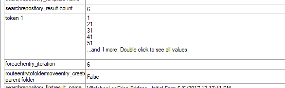

token one is the multivalue token.  How can I make this wf work.
replied on July 18, 2017 • Show version history
Yes, but those aren't the Entry IDs of your documents, that's just the Loop iteration combined with a "1" so it isn't going to give you what you want.

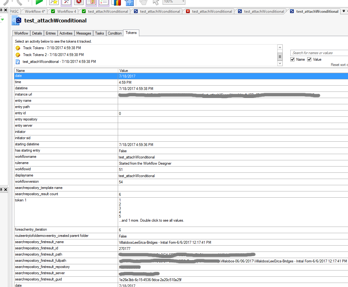

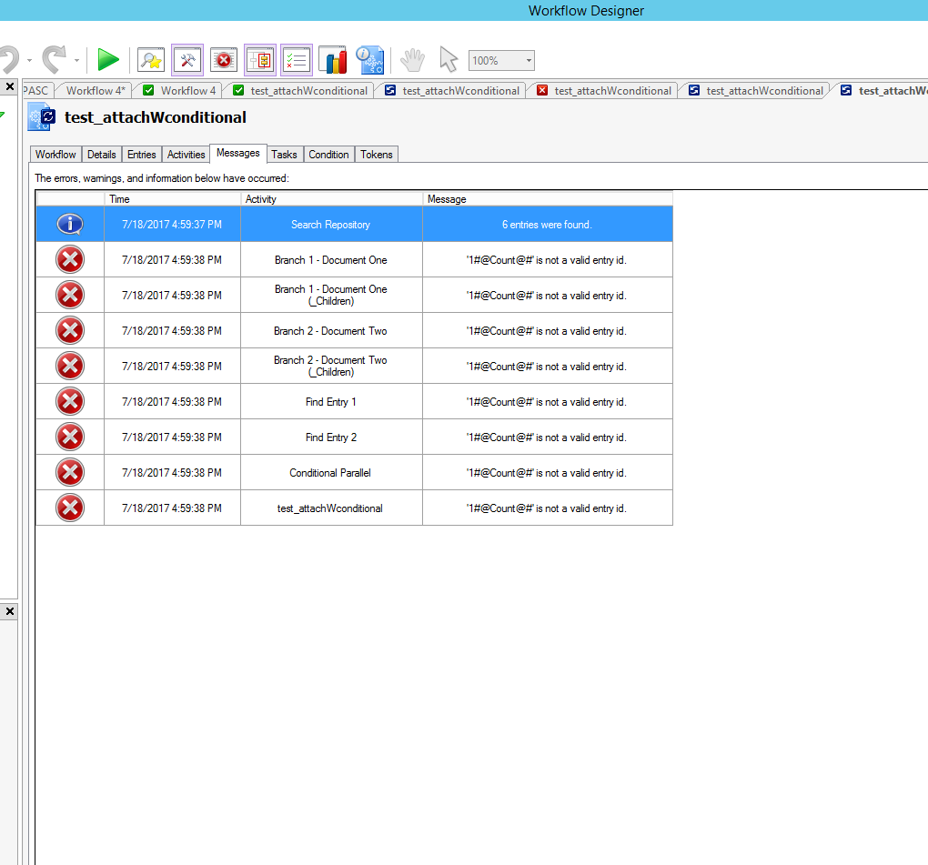

Again thank you for all your help.  Even if I change Token 1 to equal Entry_ID or Entry_Name there is currently no way to get that information to correspond to an actual attachment.
Entry one works because it is set to the last variable (doc name) run in the 'for each entry' loop.
You really need to break this apart and take it one step at a time. Each screen shot shows changes to a bunch of conditions so it is going to be incredibly difficult for you to pinpoint the source of the problem with so many things changing.
Start a new workflow, and add one activity at a time. Make sure it does exactly what you need it to do before you start adding the next activity. For example, you have "Track Tokens" and "Assign document Name" outside of the loop so it only runs after the loop is finished, not for each document.
You're getting a LOT closer on the Find Entry activities, you just need to use Entry ID in the "Change Token for Each Entry" and use Indexing in the token editor for the multi-value token because you have to tell workflow which of the values to use.
Thank you again for your recommenation.  However, breaking the wf apart would not be beneficial.
As is stands the wf works as expected.  Actually, I would have this solved if I could send the docs as a .zip file.  However, our network environment does not allow .zip files.  Which is why I need a way to capture each attachment and attach it to an email for sending.
I know the token 1 (multi-value) is working because the doc names are printed inside the email just as they are listed in the folder the items get moved to using the 'for each entry' loop.
token 1 = names of all document (all 6 are set inside 'for each entry')
token 2 = (token 1) outside of 'for each entry' ==> token 2 never gets set
I use branch one for testing.  If branch one sends an attachment then I move the same setting to branch 2.  However, a document has never been sent over branch 2.  It would be great if I could access %(ForEachEntry_CurrentEntry_Name) could be set outside of the for loop or if Token 2 could access the values in Token 1.

Have you looked at the completed workflow to see how the branch 2 condition is being evaluated? That information would be very helpful.
replied on July 19, 2017
I've attached some results information for wf
replied on July 19, 2017 • Show version history
It looks like the first reason your conditions are failing is because you entered the "#@Count#" text directly into the token. You have to use the Token Editor to get a count, index, etc.
Also, this is reason I suggested earlier that you build this out one step at a time.
Looking at your current error messages it looks like you've changed a lot of values since the last time around, and it is going to be nearly impossible to solve this with so many changes.
actually, token editor is not available in the wf as it stands.  The only place I can edit a token is within the email text of the email activity.
When you select a token value to enter, right-click the token it puts in the field. The token editor is available in all versions of Workflow.
So token 2 index works.  What should I be looking for in the condition for branch one?
You should be looking at the Count of items in your multi-value token (entry IDs) and storing that as Token 2 (not a multi-value, just a Count of items in Token 1).
In that case, the conditions would be like these:
token 2 count
Not quite. After the loop, set the value of Token 2 = %(Token 1#@Count@#)
So if you capture 6 entries in the loop, Token 2 should equal 6
Then your condition should be "If %(Token 2) greater than 0"
find entry One ==> this results in a folder link and not a file... is there something I should use instead of "Find Entry"
I'm sorry, let me clarify.
The Find Entry should use the Index on Token 1 (the entry IDs) you add in the loop.
The Branch (Branch 1 - Document 1) should use the condition I mentioned above.
To make things easier, just remember that a Condition is anything with an "If" but the value you put in the Find Entry is a parameter.
Find Entry is always the ideal if you have the Entry ID, and Find Entries is always better than a Search if you want all docs and/or folders within a specific folder/location.
Think of Entry ID like an address, whatever number you put in the Find Entry looks for the document or folder at that address, if you put at Entry ID into a Find Entries it will direct you to everything housed in that location.
