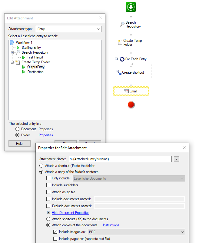

replied on June 27, 2022 • Show version history
Since attaching multiple results from a Search Repository activity to an Email activity as file attachments is likely still of interest to people who may find this post, my colleague @████████figured out a clever way to do it.
Create a temporary folder (suggest naming w/ the WF instance ID for uniqueness), create shortcuts for each file, then attach the folder to the email. Don't forget to clean up the temp folder afterward. Adding error handling for Email activity failures (for example, if the combined attachments exceed max message size) with at least a Try-Catch is highly advisable.
7 0

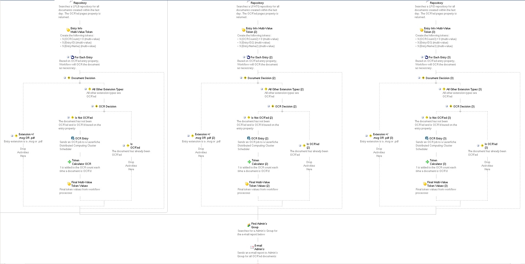

replied on March 12, 2015
Kevin,
I have a workflow set up that does a nightly search on several repositories and OCR's any documents that are not OCR'ed. I send a nightly e-mail report with the number of documents OCR'ed. I would also like to include a list of the Entry Names and Entry IDs of the documents OCR'ed. I have successfully created the workflow that retreives the entry information in a for each loop and appends the token variables. However, after I call over 10-12 appended token variables in the e-mail activity, the workflow will take a very long time to validate, publish, and run. If I call above 20 appended token variables, the workflow will not validate and publish at all. I need to call anywhere from 100-400 appended token values. Is there anyway I can configure this more efficiently or anything I can do to fix this issue? See the screenshots for more information.
Thank You,
Zach
replied on March 13, 2015
Hey Zach,
I'm not able to reproduce this issue. Are there any errors in the Workflow Admin error log or Event Viewer?

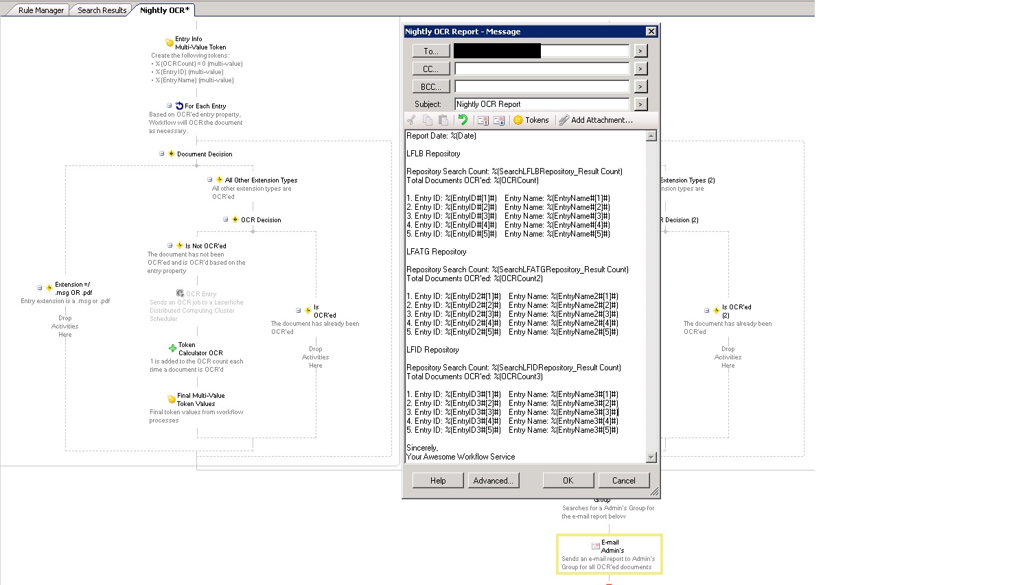

replied on March 16, 2015 • Show version history
Kevin,
I do not see any errors located in the Workflow Admin or Event Viewer that seem to be associated with this issue. The virtual server we have workflow service running on has 4GB RAM and 2 processors at 3.00GHz. The CPU will peak at 100% while attempting to validate/publish this workflow when calling over 10 appended token variables in the e-mail activity. The workflow will not publish and the CPU will stick at 100% until I cancel publishing of the workflow. You can see from the screen shots below the error log from Workflow Admin Console and how I have the e-mail configured. Any thoughts?

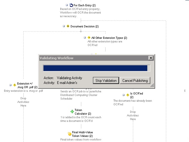

We are running Workflow 9.1.1.381 with the Laserfiche 9.1 Client Suite on our live server. I could try updating our test server first to 9.2 and see if the issues still persist. Thanks Miruna.
There were a couple of optimizations made to 9.2 for publishing workflows with lots of tokens.

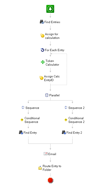

I found a workaround for the problem of making multiple attachments when WF must iterate to find those attachments:
Since the email activity has to have an instance of an entry in order to make the attachment, I run a parallel with a condition nested inside of it. If there is a found entry with an index # it finds the document and therefore makes it attachable by the email activity.
So far, there is no lag in the multiple parallel activity. I have 10 branches. The lag comes when I the entries are converted to a PDF in the email activity. Total time has been under a minute even with 10 attachments.
I was following this thread trying to find a workaround. Hopefully this gives you an idea. There are more details to the solution. Let me know if you are interested and I am happy to share.
Cheers!
4 0
replied on July 23, 2015
I am interested in a solution for this as well, but do not understand your reference to an index #.  Do you mean the iteration of a duplicate named file?  If so what if your looking for all the files that were independently uploaded to a form plus the form all uniquely named, but names are unknown to workflow?  The only common piece of information to base the search is the BP Instance ID assigned to a metadata field.  Any ideas?
If the instance ID is unique, then you can use a Search Repository activity to find all entries which have a certain value in that metadata field, just like a search in the Laserfiche Client. Then you can collect them names as shown above.
The reference to indexing is just a way to properly display the tokens. Putting a multi-value token in a text field will usually only display the first item, so index them to show all values. The syntax %(Multi Value#[,]#) means display all the values and separate them by a comma.

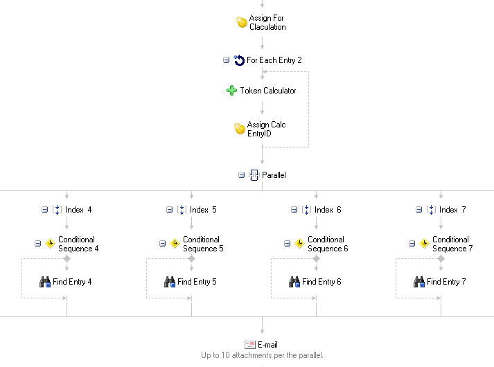

replied on July 24, 2015 • Show version history
Kip, let me take apart your message and reply to it.

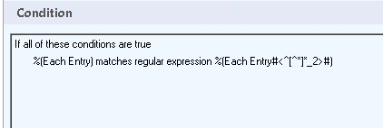

No, it is the iteration of each attachment you need to make. The above activities exist within a 'For Each' activity where each entry is one that you need to attach to an email. I use the token calculator to 'add 1' before each entryid.
Token calculator:
Token including calculator digit:
The 'each entry' token is used later conditionally to process in the parallel 'index' branches:
The example above is on the Index 3 branch.
Lastly, I use the Find Entry activity to find the relevant entry without the preceding token calculator digit:
Once you use the Find Entry activity, you can attach it to an email. The only downside to this workaround is that for each attachment you need to make, you must have a parallel branch.

replied on April 7, 2016

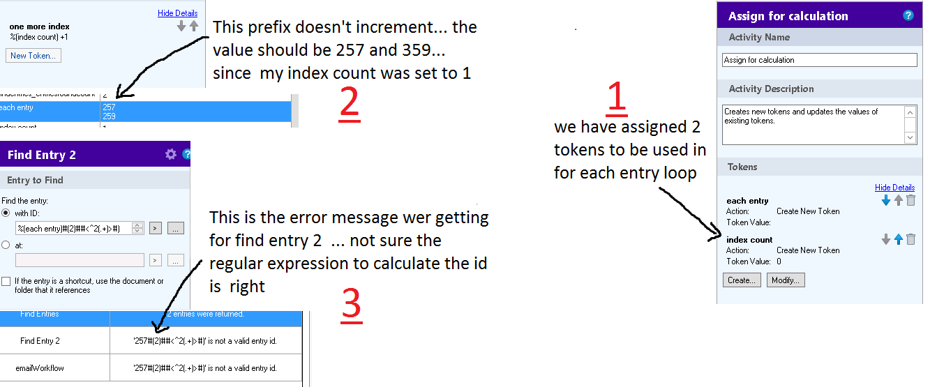

Hi Chris,
This is a great post. We have exactly the same need so we tried implementing the workflow which you have described. I have attached my workflow here with this post <email workflow.png>
1) I have defined 2 tokens required for each entry loop
2) Token calculator doesn't seems to increment
3) Find entry 2 - with ID: regular expression to locate the correct id seems to be not working
for 1,2,3 errors refer attachment <errors and issue.png>
Please help me with this issue...
thanks in advance
Rajah
Raja, I'll need to refresh my memory. I'll get back to you ASAP.
thanks a lot chris ... that will be very helpful
replied on April 10, 2016
Hi Chris
Did you get any chance to look up !!!
replied on April 20, 2016
OK Raja, I found some time. I see some things that need fixing in your pics.
Here are your questions:
Make sure they are empty in your "assign for calculation" activity. In other words, no data should be in the tokens that are there. "index Count" should be 0 and "each entry" should be empty. They get modified later and then data is added.
Make sure your activity "assign calc entryid" modifies the "index count" token with data from the Token Calculator. Also make sure that the "index count" token is a 'modify' token.
Since the Token Calculator is not naming the entries correctly, the Find Entry (and Find Entry 2, etc.) won't find a match. You also must put the Find Entry activities within the conditional sequence. You don't want to run X number of Find Entry activities if you don't have to. If you nest the Find Entry with the conditional sequence, it only Finds the Entry if there is one there. Here is what my conditional sequence rules look like for Index 2:
Each of your issues are dependent on one another. Start with your first issue and then troubleshoot your way down your list.
Hope this helps,
Chris
replied on April 21, 2016
Hi Chris,
Thanks a lot. This was really useful. Now my workflow works perfectly. Thanks again.
Regards
Rajah
