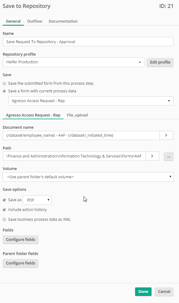

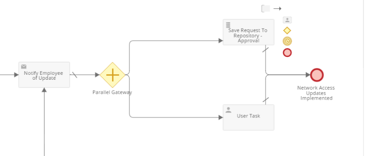

replied on May 8, 2017
So the Agresso Access Request- Rep form is used in the Save to repository service task? Can you show the configuration for it? For testing purpose, please use this form in a user task as parallel of the save to repository service task and set "Make form read-only for users the task is assigned to" and test whether the checkbox can be correctly removed when load the read-only form in the user task.

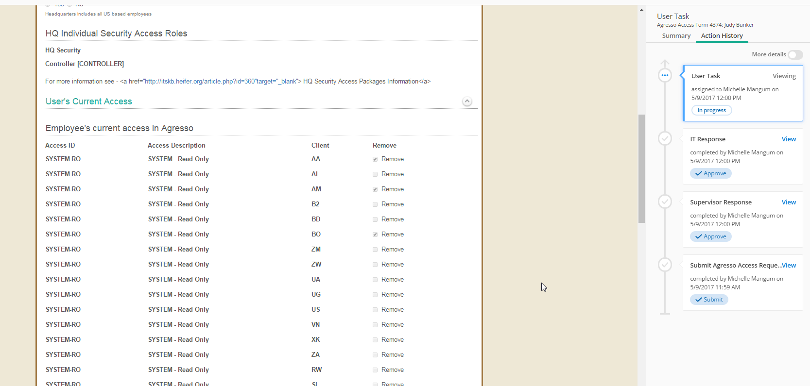

replied on May 9, 2017
Made changes as you suggested and took screen shots of the settings/results

replied on May 10, 2017
It seems the script doesn't run at all for your process. You can open the task using Chrome and click inspect to open the Developer tool and check whether there is any error in the Console tab. If there is no error, then you can debug as I demonstrated here to check whether the JavaScript is executed when load the form.  And you also can just test the JavaScript with a simple form that only have the table and only have that piece of JavaScript.
replied on May 16, 2017 Show version history
So - I think I found the issue with this - the form being used to save to the repository wasn't a form that was being used in any step - so I changed to the forms being used in the step before moving to the repository and it HID all the checked fields - I thought someone had responded here to show me the opposite code - but I don't see it.  I need to only see the checked boxes. I tried .show and this
