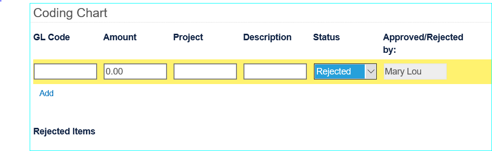

In my preview, if "Rejected" is added as the status, a  field appears for a reason to be entered.  This is done using two tables that interact with each other.  Rows in the second table are hidden until the status is rejected.
Here is my the section in preview mode...
If I actually run the process, the rejected line will not appear as soon as rejected is selected.

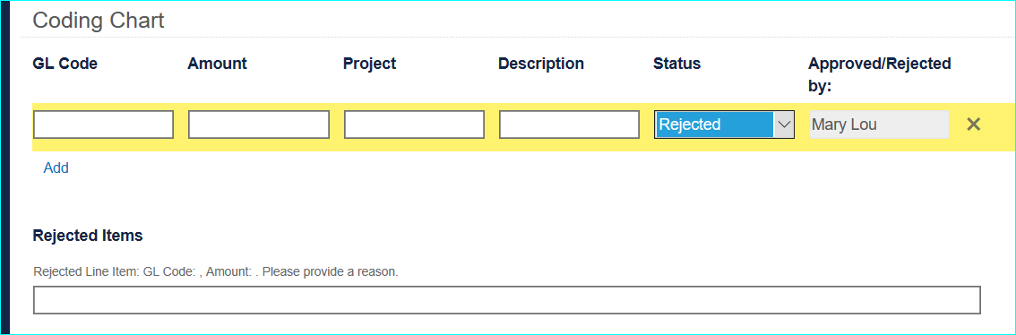

Here is a snip of the process form...
The rejected reason row will not automatically appear.  It will only appear if the "add" button is selected. I tried a work around by adding a row automatically. This worked, but it triggered too many rows. Since this was adding so many rows, I decided to remove it.
