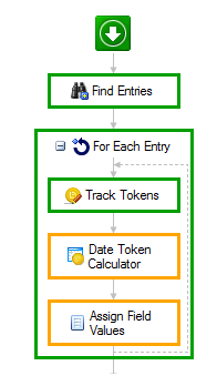

I keep getting an error from a Date Token Calculator activity in a work flow, which appears very familiar to the issue posted here https://answers.laserfiche.com/questions/91377/String-not-recognized-as-a-valid-DateTime-error-when-looping-through-search-results#91660, which had no resolution.

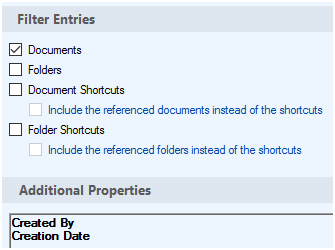

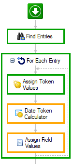

I am using a Find Entries activity and retrieving the Created by and Creation Date tokens.  I am then using a Date token Calculator for Each Entry found by the Find Entry Activity, attempting to take the creation date & time and adding X minutes to it.  I keep getting the error on the Date token Calculator “String was not recognized as a valid DateTime.”

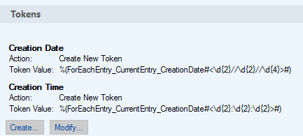

I have also tried separating the Date and Time from the Creation Date Token, via Assign Token Values, and then entering them into the Date Token Calculator, but get the same result.
How can I use the entry creation date in a date token calculator and not get this error??

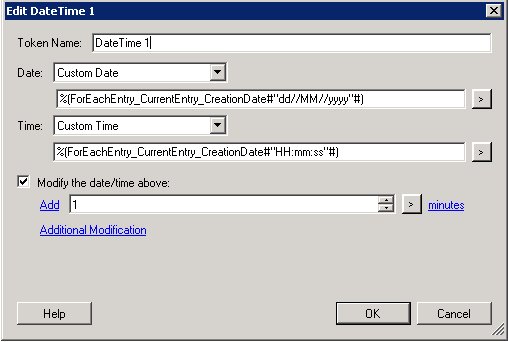

Ok, that's what I thought is happening. Your server is running with a date format of dd/MM/yyyy, but For Each Entry gets the value as MM/dd/yyyy. This is a bug (reference #155528).
Try setting up your Date Token Calculator like this:

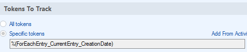

Can you add Track Tokens so we can see the exact values you're working with? What version of Workflow are you using?
replied on March 15, 2017 • Show version history
Miruna,
Version 9.2.0.167
See below:

Made the changes, same result "String was not recognized as a valid DateTime"
Sorry missed the double '/' in your post, the #"dd//MM//yyyy"# did the trick.
Thank you

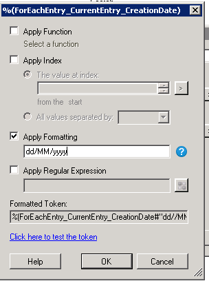

No problem. The easier way to format tokens is to right-click on them and open the Token Editor:
Then you can write the formatting and the Designer will take care of escaping the special characters and putting it into proper syntax:
