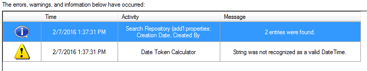

I ran into an odd error, odd in that when I'm dealing with just 1 result, the date comparison works. But as soon as I have more than one, the workflow terminates with the "string not recognized as a valid DateTime" error. So whether I try to do a "For Each Entry" on 2 results or all results, the error happens. But a simple comparison with 1 result won't trigger the error.

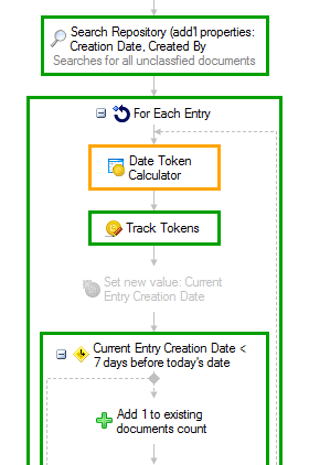

Here is the simplified workflow I've been using to test various scenarios and try to find the error:

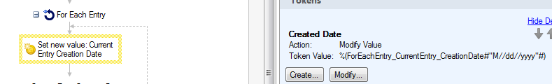

I save the Creation Date of the current entry when entering the loop:

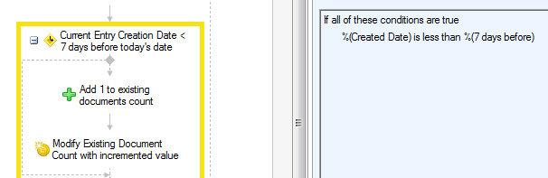

First conditional statement (the second is the same except, of course, the comparison is greater than or equal to the "7 days before" date):

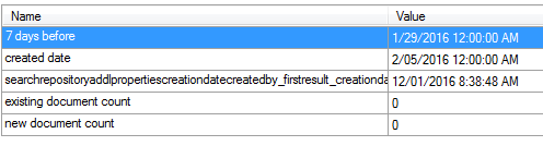

Tracking the tokens produces this result:
The date formats appear to match but the error happens on the first conditional evaluation:

Thanks for the suggestion, Junaid. I get "String was not recognized as a valid Date Time" on that activity:
If definitely seems like the "For Each Entry" activity is messing with the date comparison. For the time being I'm just going to run two separate searches (one for new documents, one for old) and then process after the fact.
