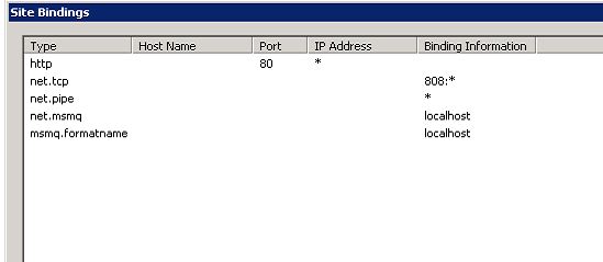

I did a compare to my Empower virtual machine running 10.2 and noticed bindings only have http & https for IIS. I have attached my bindings and there are bindings for 'net.tcp', 'net.pipe','net.msmq' & 'msmq.formatname'. Is this normal? Can they be safely removed?
replied on February 20, 2017
Those are the bindings for Windows Message Queuing. They're not using port 80.

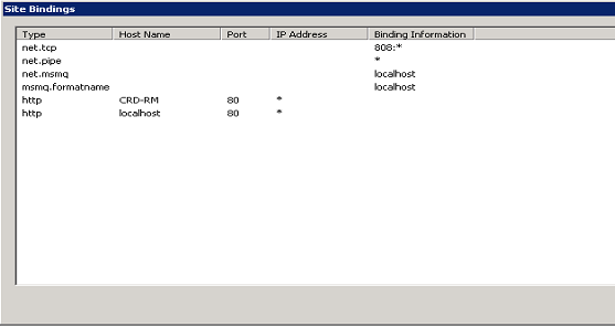

Worked more with our vendor and found a workaround for the problem. Changed bindings as follows:
where crd-rm is our server name. Removed the original blank host name for port 80 and added to specific bindings for host 'crd-rm' and 'localhost' for port 80. This works and resolves properly. Still not sure why the blank host for port 80 would not work but everything seems to be working fine now.
