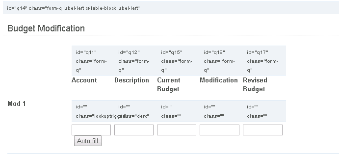

Forms - Making the pesky AutoFill button be Automatic
posted on February 3, 2017
Continuing on the subject in this post about making the auto file automatic (https://answers.laserfiche.com/questions/48879/Auto-Fill-Button )
I have added the javascript with the for each function but only the first row is automatically populated. You still need to click the button manually on row 2+
I thought the For Each function was going to handle this. Am I missing something that is skipping the additional rows?
    $('.lookuptrigger input').change(tableAutofill);
    function tableAutofill() {
        $('.cf-table-block tbody tr').each(function () {
            $(this).find('button.autofill').trigger('click');

replied on February 3, 2017
Try this one:
function autofill() {
    $(this).closest("tr").find('button.autofill').trigger('click');
  $('.lookupCondition select').on('change',autofill);
  $('.cf-table-add-row').click(function () {
    $('.cf-table-block tr:last').find('button.autofill').trigger('click');
For some reason this function doesn't even populate the first row. I wish this button would just go away, the lookups normally  just run when data is populated into the specified fields. Here is my altered code, I just changed the name of the class to fit mine.
  $('.lookuptrigger select').on('change',autofill);
I forgot that one triggers off of a drop-down field. That's where the .lookuptrigger select comes.
Oh right! I missed that, going to try again
Works perfectly! This is gold, I really didn't want to have to tell them they need to click an autofill button on only one form. Thanks so much!
