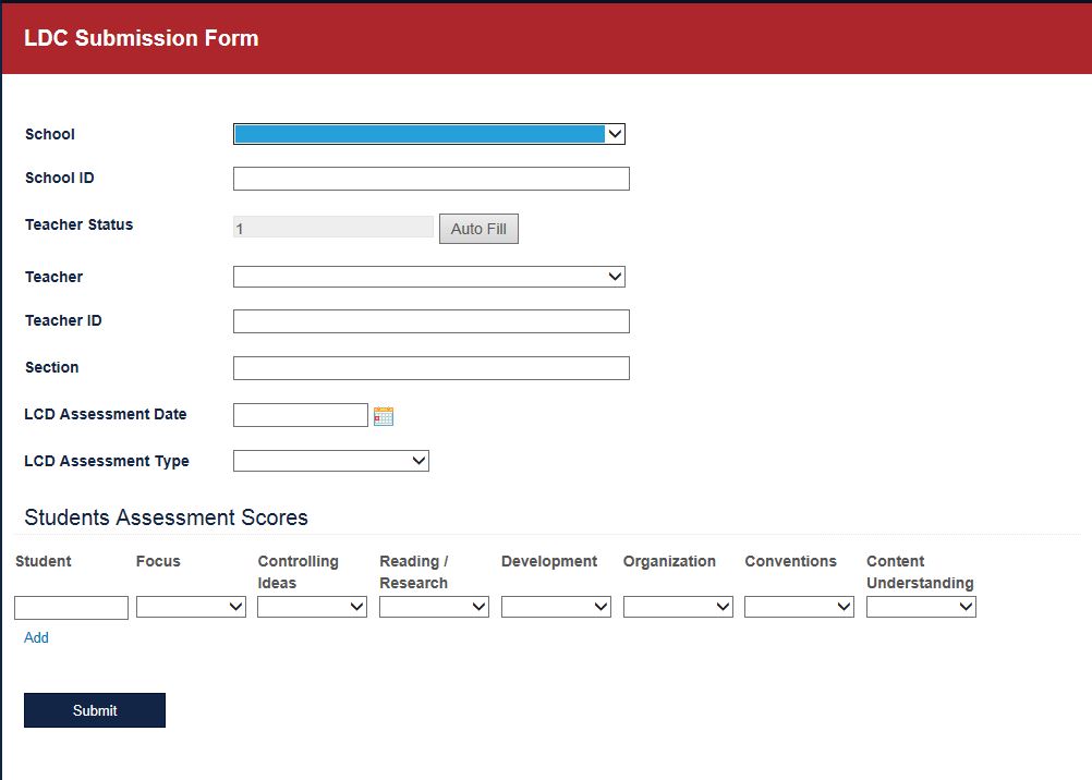

I have been putting together a form that does a data source lookup to populate some of the fields. I currently have it so someone chooses a School ID and if the Teacher Status = 1 in the table it shows teachers with that status. Next to my status field there is an Auto Fill button that has to be clicked before the teacher information is populated. Is there a way to make the Auto Fill button go away? Why is it there? I plan on hiding the Status field, so I don't want anyone to have to click a button before getting the list of teachers.
replied on January 22, 2014
The button appears because you have multiple conditions that must be met before the lookup will happen. There should be a pretty straightforward way around this. Here's an example. The fields that are used in the conditions for the lookup rule are given the lookupCondition class.

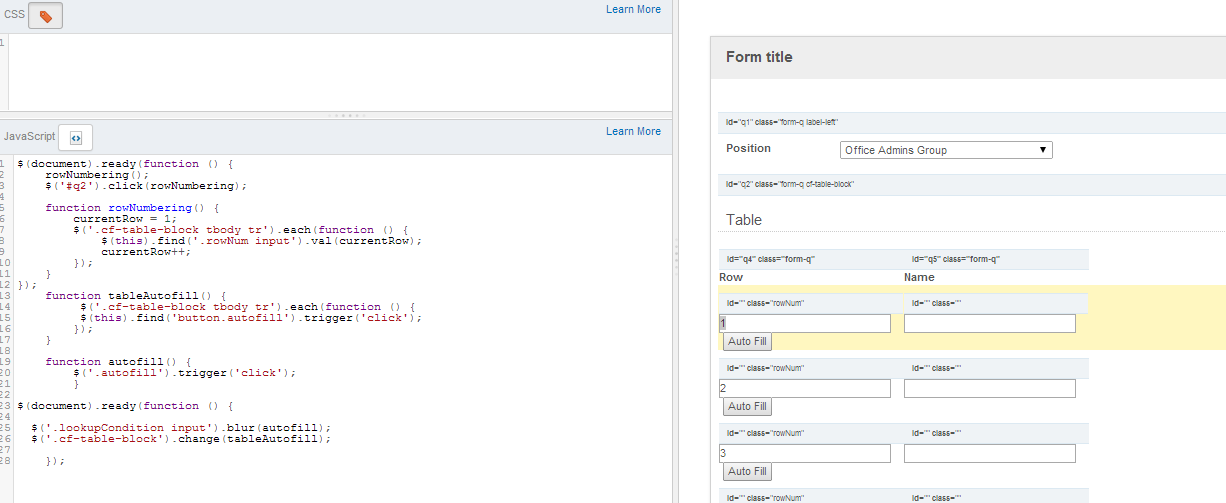

replied on August 5, 2014
Hi Eric,
I am unable to get this to work, I first have JavaScript populate the row number, which you helped me with.  I now need it to wait until a position is selected in a drop down and then the auto fill button "pushed".  Here is what I have.
    rowNumbering();
    $('#q2').click(rowNumbering);
    function rowNumbering() {
        currentRow = 1;
        $('.cf-table-block tbody tr').each(function () {
            $(this).find('.rowNum input').val(currentRow);
            currentRow++;
    function tableAutofill() {
          $(this).find('button.autofill').trigger('click');
    function autofill() {
        $('.autofill').trigger('click');
  $('.lookupCondition input').blur(autofill);
  $('.cf-table-block').change(tableAutofill);
replied on August 6, 2014
Hi Jessica,
Try this:
    $('#q1 select').change(tableAutofill);
    rowNumbering();
        currentRow = 1;
            currentRow++;

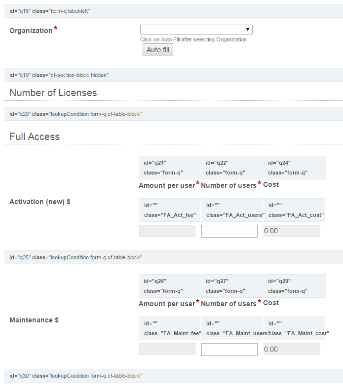

replied on November 20, 2015
Hi Eric,
I have a drop-down for selecting Organization and a lookup rule to populate 'amount per user' in 6 different tables. I would like to look for an alternative to auto fill button as sometimes the user might not click it.
I've tried making the 'amount per user' fields required, both via Forms as well as javascript, but the form can submitted with no input in them.
Thanks
