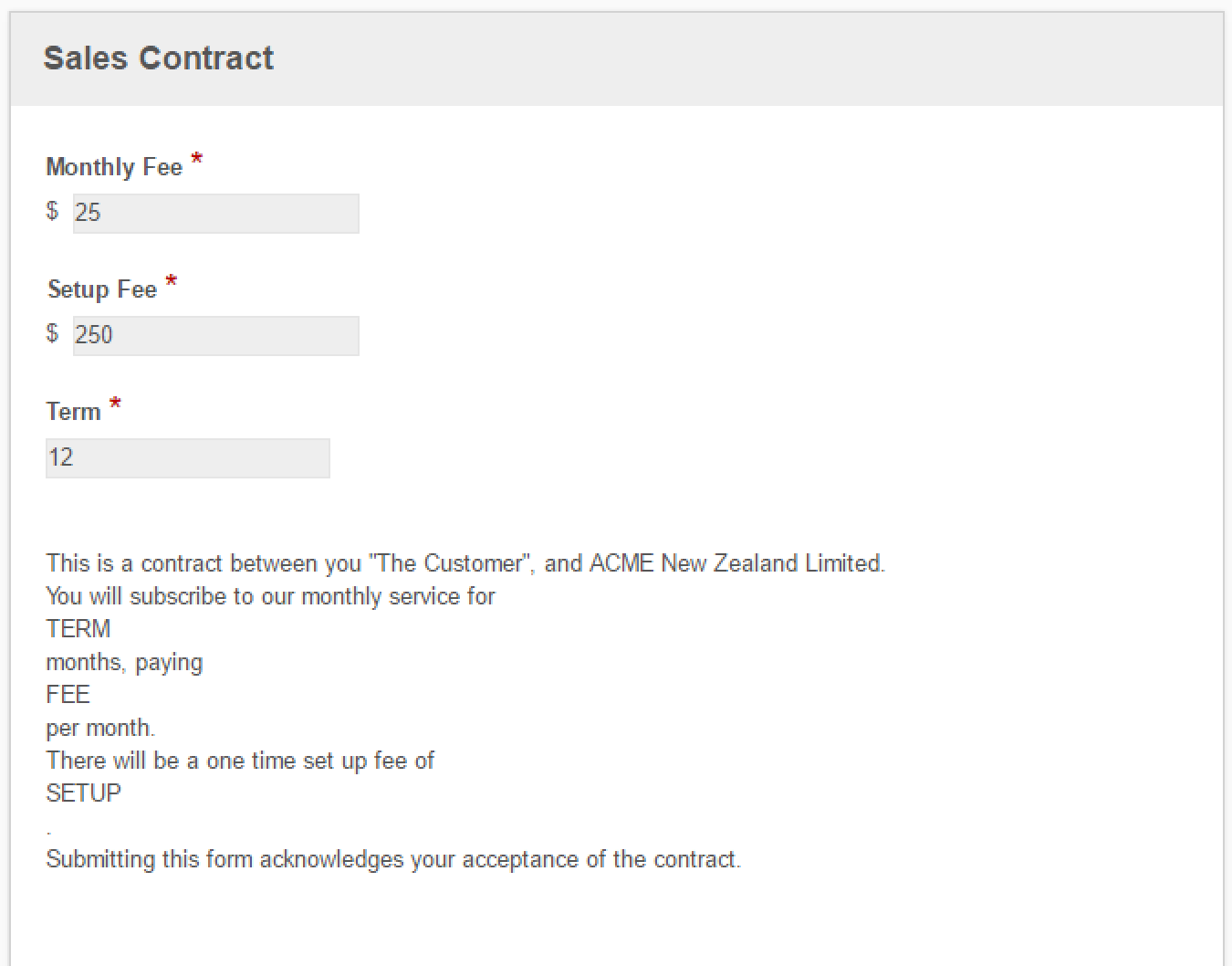

Here's our example Sales Contract:

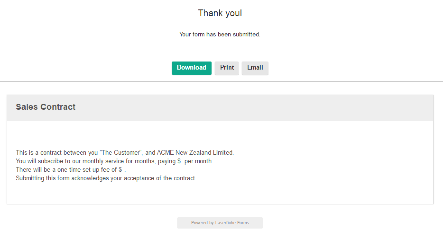

When you submit the form, you are met with this:
Notice that the values above are stripped from the Form. This wasn't always the case - and in the past these values would stick around and be stored. (Again, see Eric's post above for screen shots of this)
Our example form is very straight forward and includes the following fields:
The HTML block contains the following code:
<br>This is a contract between you "The Customer", and ACME New Zealand Limited.
<br>You will subscribe to our monthly service for <div id="txtTermPlaceHolder">TERM</div> months, paying&nbsp;<div id="txtFeePlaceHolder">FEE</div> per month.
<br>There will be a one time set up fee of&nbsp;<div id="txtSetupPlaceHolder">SETUP</div>.
<br>Submitting this form acknowledges your acceptance of the contract.
The Javascript used is:

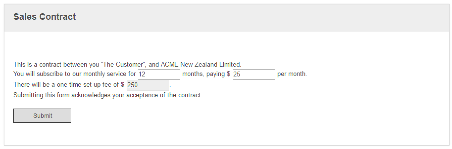

And the output should look like:
