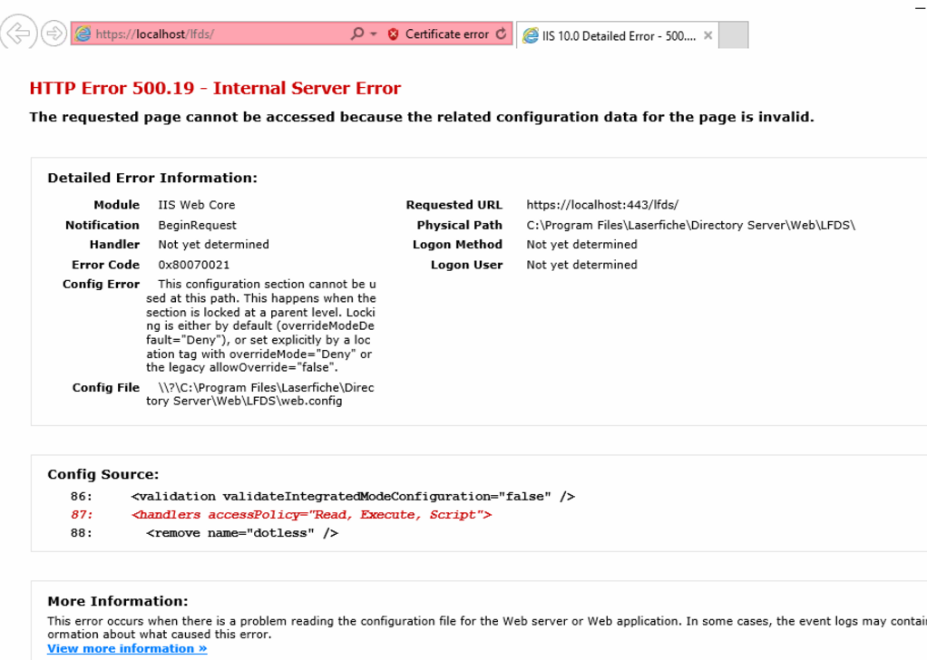

Raymond Cruz with LF Support recommended we bypass the requirement, but after doing so, the LFDS site doesn't work, giving an HTTP error.
Raymond provided this blog post, citing Solution 7:
https://blogs.msdn.microsoft.com/webtopics/2010/03/08/troubleshooting-http-500-19-errors-in-iis-7/
However, Solution 7 indicates that an ASP.NET dependency is missing, see last paragraph of solution.

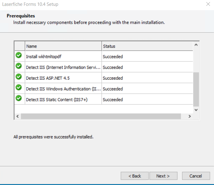

We found this article, and after using the first resolution (using DISM to install .NET 4.5), the installer  was happy and we could proceed.  We can now see the licensing site and configure it.  I suggest this appears to be a bug or deficiency for the LFDS installer in a Windows Server 2016 environment.

This worked for me where none of the other solutions on this thread worked. Thanks Cameron!
replied on June 4, 2019
This also worked for me with the /all switch.
dism /online /enable-feature /featurename:IIS-ASPNET45 /all
THANKS Cameron!!

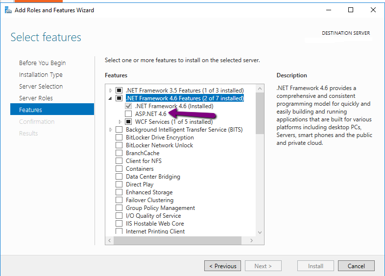

ASP.Net is a feature under the .Net framework in Windows 2016. And Chris is right, it's .NET 4.6:
Edit May 2, 2018:
On newer versions of 2016, there is also a ASP.Net checkbox under IIS.

What exactly do you have installed under .Net 4.6 in Windows?
Actually, it looks like the latest updates to Windows 2016 brought back the second checkbox and you now also have to check  ASP.Net 4.6 under IIS.

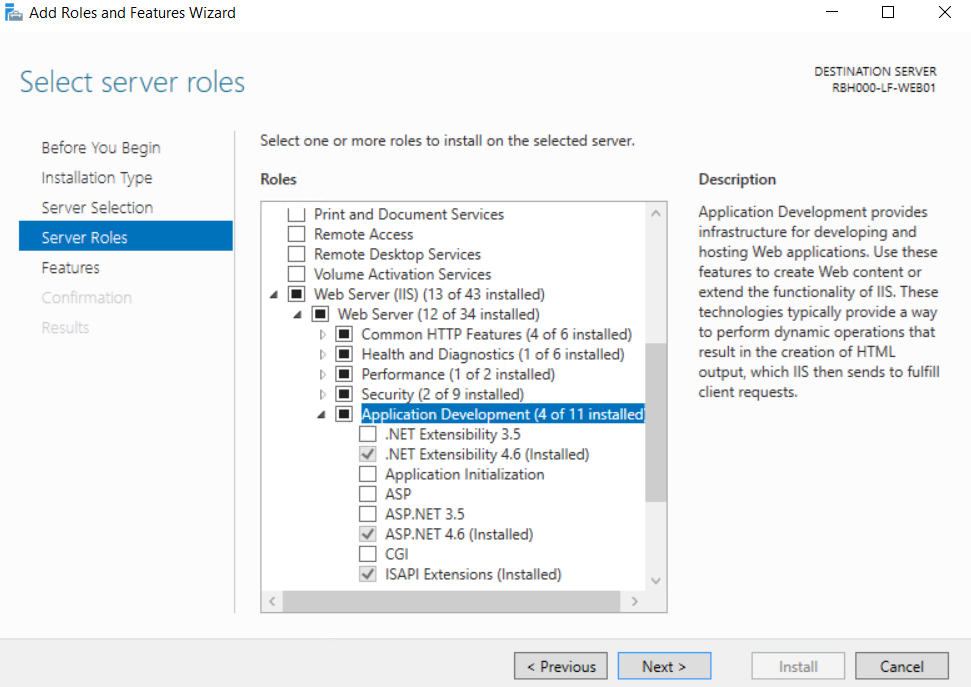

I was having similar issues while installing Laserfiche Workflow 10.2 on a Windows 2016 Server.  After reading this post, I found that installing ASP.NET 4.6 under Weber Server-->Application Development allowed the prerequisite for ASP.NET 4.5 to succeed.
The version of Laserfiche RIO I installed it from is 10.3.1.181_20180731. So maybe the problem is now resolved.

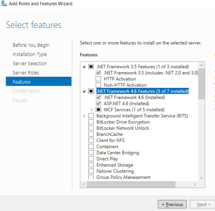

replied on March 4, 2019 • Show version history
I ran into a similar issue and was able to fix it with this configuration.
Originally I only had ASP.NET 4.6 under Features and it wasn't detecting ASP.NET 4.5 as a prereq. So I added:
1. ASP.NET 4.6 under Server Roles>Web Server>Application Development
2. ASP.NET 3.5 under .NET Framework 3.5 Features (for good measure)
Then the prerequisites went through

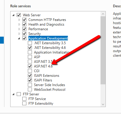

replied on September 11, 2023
This same configuration step works on Windows Server 2022 Standard.
(Replace 4.6 with 4.8 in the screenshot)
All the following features in Application Development must be installed to meet the prerequisites. Laserfiche installation packages and prerequsite instructions need updated.
