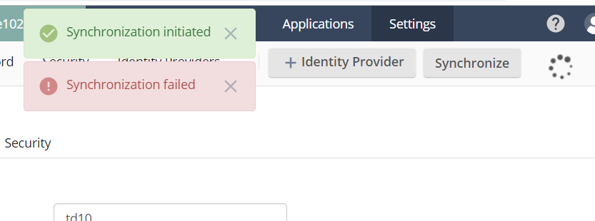

If you manually attempt to synchronize, there should be two notifications at the top. If it fails, it looks like this:

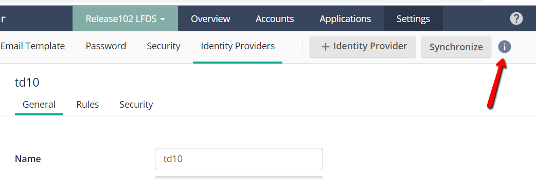

You can also view the status of the last sync:
