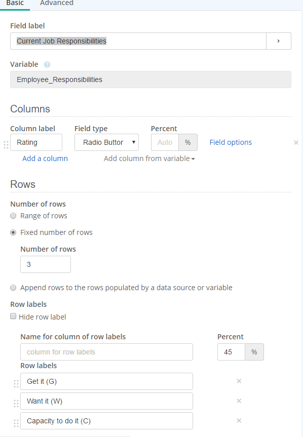

I'm looking to add some type of tool tip to my table rows. I know this functionality isn't available right now. but is there any work around that can be created. I have looked on http://www.w3schools.com/ and haven't had any luck. Any help would be great.

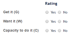

The rows aren't given unique IDs like the columns are. However you could use pseudoselectors on the tr elements of the table. I gave the table element in Forms the ".table" class for reference, then used the following JavaScript:
  $('.table tr:first-child').attr('title','The "Get it" row comes first.');
  $('.table tr:nth-child(2)').attr('title','Next comes the "Want it" row, second.');
  $('.table tr:last-child').attr('title','Last of all comes the "Capacity" row.');
This had the result in the attached video table-tooltip.swf. (I wasn't actually clicked into the browser at first, so there's a little delay in the beginning.)

I want the table rows to be able to have a tooltip option but that isn't available. I want to show a description of each row. A definition of each type of evaluation value.
replied on January 6, 2017
So the /*selector*/ is where I would put the row id #? Not sure what they are because they are blank. I am a tad confused when it comes to the table reference id's.
Thanks James!!!! This is exactly what I needed and the reason why I couldn't get it to work. I was looking for id's!
