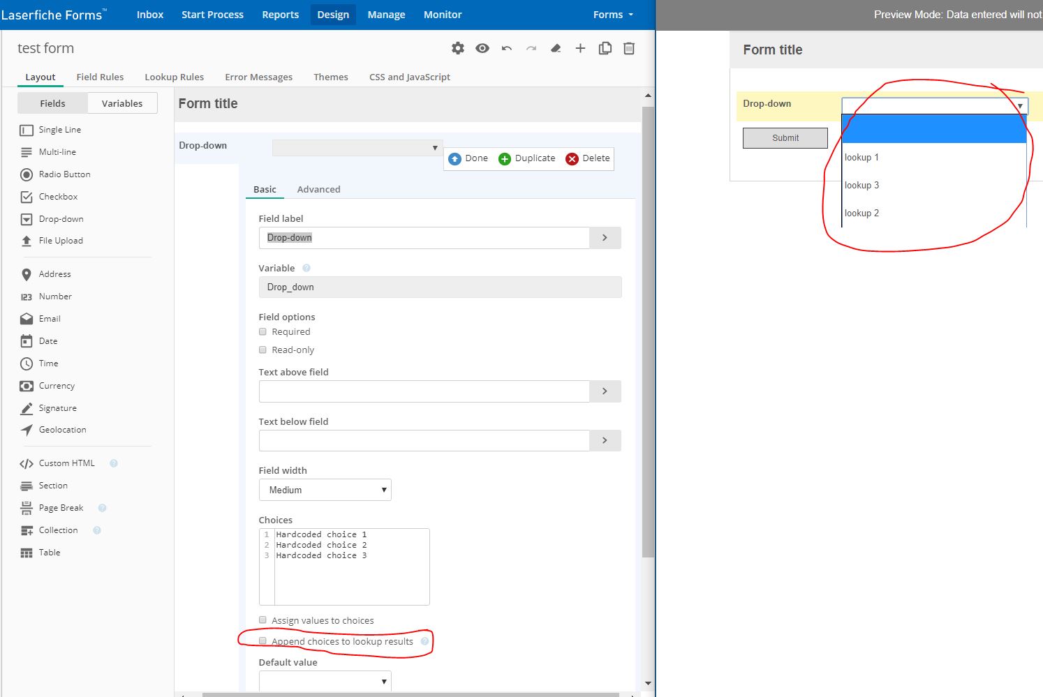

Without option "Append choices to lookup results"

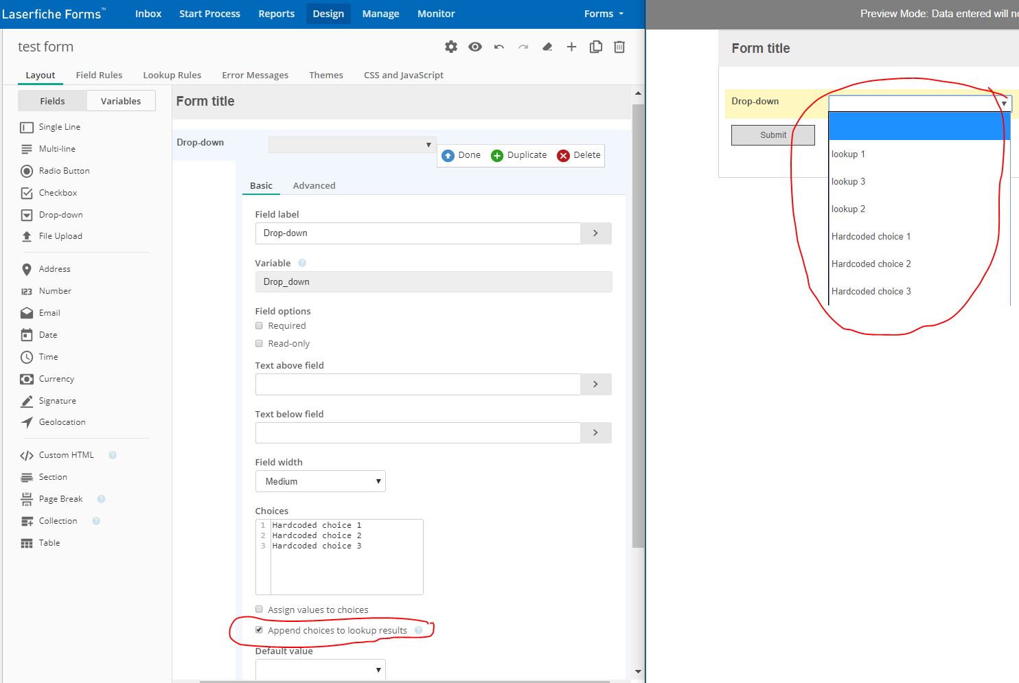

Values returned from the lookup , but dont display another options
With  option "Append choices to lookup results"
there is no option preselected with lookup values returned.

I've included some screenshots below that illustrate my testing and results:
Here's the table I created for the lookup:
As you can see in the attached "Append Unchecked" image, I have my hardcoded options configured, append choices unchecked, and no default value selected. The result of this is that there is no default value for the drop-down, and only the lookup values appear.
In the "Append Checked" image, the result is that there is no default value for the drop-down, and hardcoded options are appended to the list of lookup values that are populated.
