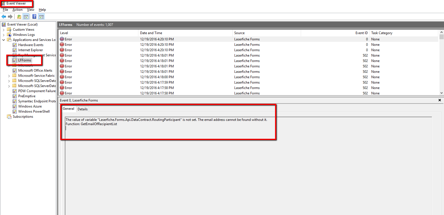

Hi Helen,
Can you post the detailed exception trace? You can find it through the "Event Viewer" under the windows system where Forms server is installed. The Forms errors should be logged under Applications and Services Logs, LFForms session.
https://www.laserfiche.com/support/webhelp/Laserfiche/10/en-US/administration/#../Subsystems/Forms/Content/Administration/Troubleshooting.htm?Highlight=LFForms

replied on December 19, 2016
Hi Helen,
This error seemed that it wasn't thrown from LFForms, it seems it's an issue when you deal with Kerberos, but Forms doesn't use it for authentication. So if you don't mind, can you try to not use any other software to extract the event logs, and to use the Windows default event viewer to provide me the details about the error only under LFForms session? Like this below, select the errors which come out when you submit the form, and the information under General tab is needed.
Regarding the employee profile, you may want to check the whether the output of the stored procedure is correct. If the employee information is stored in a table, you can just use the table for the lookup rule as well. Basic idea is to make the profile id as a condition, when it matches the key just fill the first name with the column first name. However, it really depends on your design, and I need more information (like what's the functionality of the stored procedure, which way do you prefer it to work) to further analyze this as well.
Thanks,
Ming

replied on December 21, 2016 • Show version history
I checked my Windows Event Viewer (Local) , There is no LFForms existed under the Applications and services Logs .  Is it a permission issue, or something else?
I may not have permission to the Windows system log.  However, I user EventLog Analyzer to sort by Windows Event Log. Then got a report. please check the attachment.

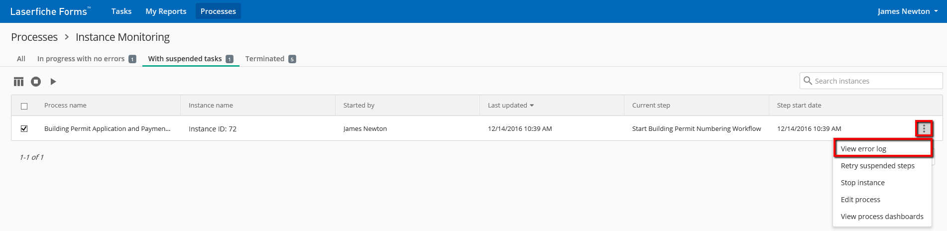

replied on December 23, 2016
Hi Helen,
It is unclear how the Unexpected Error message is manifesting; nevertheless for this kind of error, as Ming suggests, you should check the LFForms event log. Usually for this sort of thing the LFF502-UnexpectedError code is part of the message so you can try filtering based on that.
If the process is actually suspending at a step, a process or system admin can check the instance error log for more details as well. (attached image)
At this point you should reach out to your reseller for additional training and troubleshooting assistance. This is not an appropriate place for such in-depth troubleshooting. If your reseller is unable to identify a solution, then as Ming has suggested they can open a support case and we can look at the specific process, etc in greater detail.

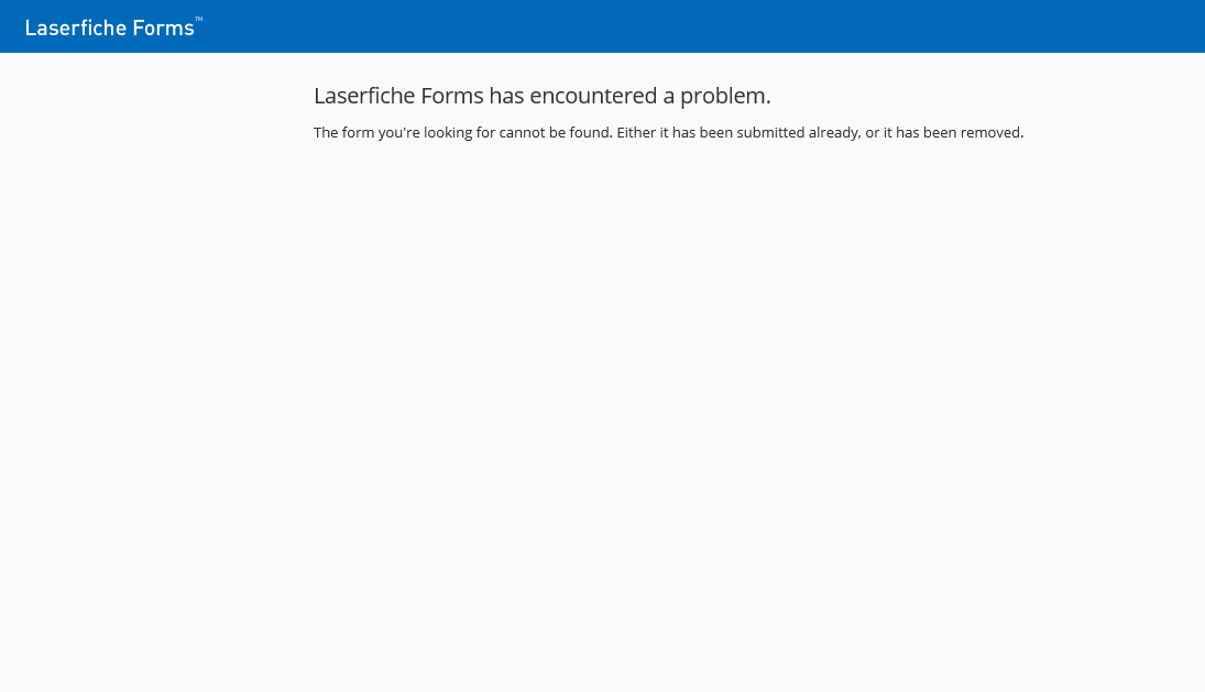

replied on December 23, 2016 • Show version history
Hi, Ming and James,
the LFF502 UnexpectError has been fixed. The form processed very good at my side. However,  when the forms saved to my supervisor's email (other than mine before submit), When He opened email, clicked the Form linkage and logged in, It shows the error " This form you're looking for cannot be found Either it has been submitted already or it has been removed" at my supervisor's account, although he has been added as user/ submitter.  And also,  both reasons are not true. I didn't submit the form and I can open the forms after sent the saved emails to his email. Need help please! Thanks! Helen

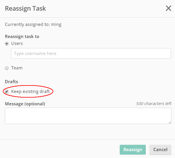

replied on January 18, 2017
Hi Helen,
I'm assuming your form draft is saved from Message Start Event since it is the place that you can save a draft to an email address. The user who saved the form draft will be the only one who can access the draft in this case, regardless whether the process is published or not.
On the other hand, if the form draft is saved in a user task, when you try to reassign the task, it will provide you an option with either to keep the draft (as below picture). If the other user who got reassigned the task has admin rights, he/she will be able to view/modify/delete the draft. Otherwise, the other user can only view the draft. Maybe you can try this workaround to share the view rights for forms drafts.
In your case, I would suggest using a user task: 1st manager complete his comments (User Task 1), the reassign the user task (with the option "Keep existing draft selected") to nest manager to complete the form and submit it. So that the managers can share the comments between each other.

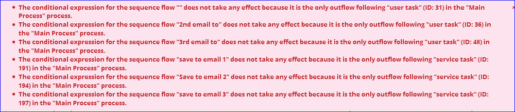

replied on January 18, 2017 • Show version history
Hi, Ming, the first email setting goes well, however, the 2nd , 3rd ones get error message:
If the exclusive Gateway has taken care of the email task, do I still need to assign a email Service tasks?  Actually, there is not reassign option in the User Tasks. Whenever, I select Assign to team or user , there is no Reassign option

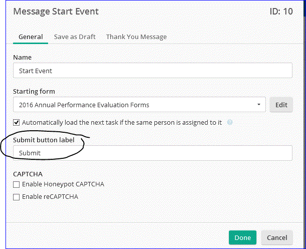

OK, Ming,
found another issue, at the Message Start Event,  in General, it shows Submit button label "Submit" before "save as draft" does that is the problem? Please check the attachment.  And how can I set "Save as Draft" first ?
And I assign all the managers and directors as Process Admin like myself.  There are nothing changes.
Thanks!
