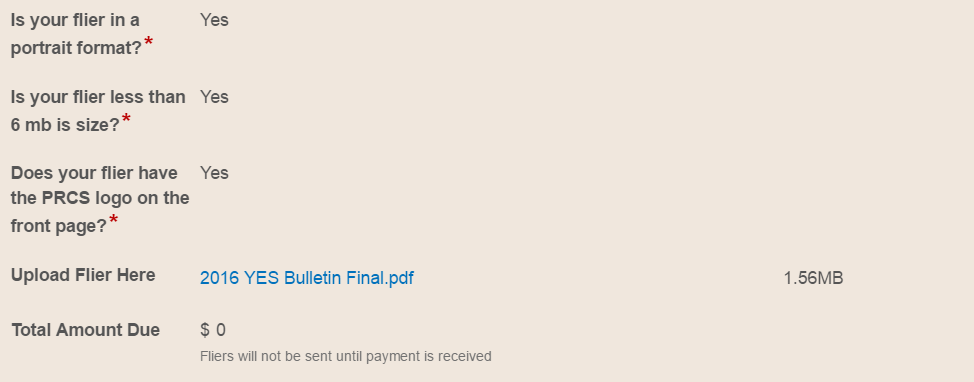

replied on December 20, 2016
Update on this:  The caculated value is not coming through when the task is assigned. It works prior to submission, but not after.  So the approval task shows $0.
Any thoughts on this?
Thank you.
No Money.PNG (23.93 KB)
It appears this has to do with the field being "Read Only".  When I remove this option it works upon submission.
Leave the "read only" option for that field unchecked on the form itself, but use javascript to make the field read only. See if that addresses the matter.
