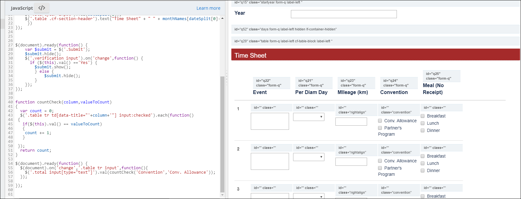

replied on October 10, 2017
Can you upload a screenshot of your form from the Javascript/Css page. I need to see the Table selector and column headings.

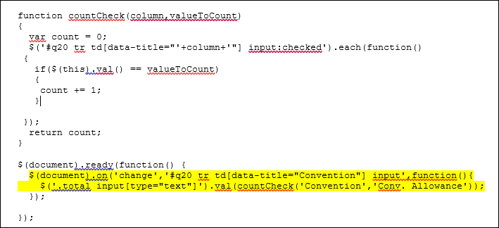

replied on October 11, 2017
Here are a couple of snips from the script page, and one from the preview pane.
The first one is the table and code (starts line 40).

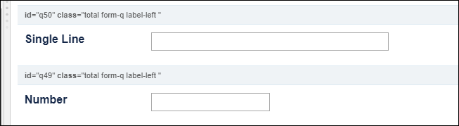

The second one includes the fields I am putting the info into.  The names will be adjusted.  I just threw them in here to make sure the count worked.  One is a text field and one is a number field.

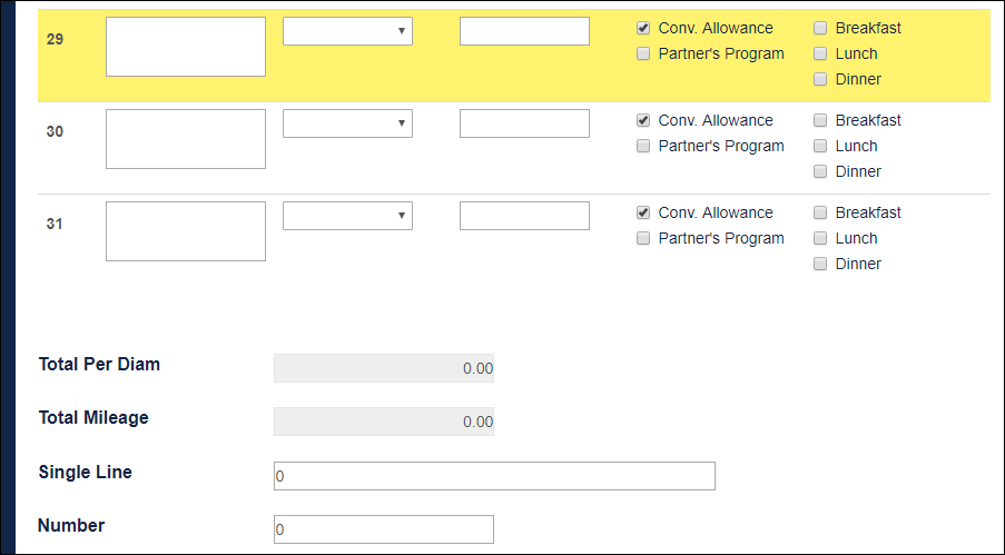

Here is one more snip of the preview.  It is the bottom of the table and includes the two test fields.  I have selected a couple of items to illustrate what is happening.
Ultimately, I need to total all Conv. Allowance checks and all Partner's Program checks separately and populate fields.
Hmm it all looks ok. I can see you have multiple $(document).ready() calls but that shouldn't cause this. Try the code below as is and let me know how it goes.
function countCheck(column,valueToCount)
  var count = 0;
  $('#q20 tr td[data-title="'+column+'"] input:checked').each(function()
   if($(this).val() == valueToCount)
    count += 1;
  return count;
  $(document).on('change','#q20 tr td[data-title="Convention"] input',function(){
    $('.total input[type="text"]').val(countCheck('Convention','Conv. Allowance'));
