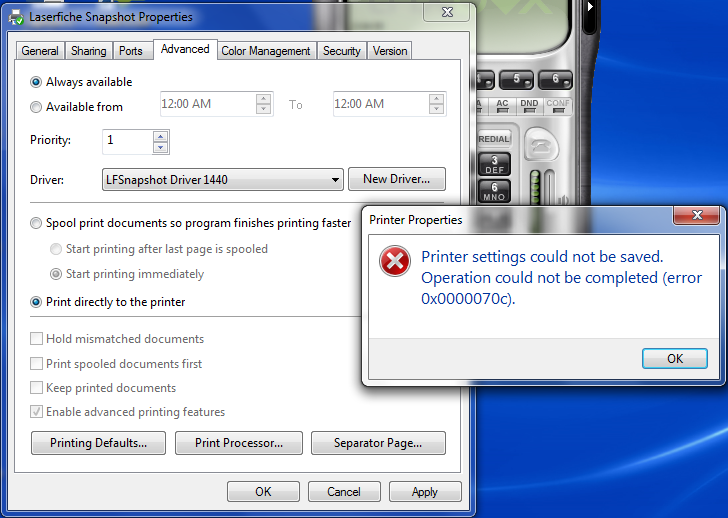

I am getting an error when trying to have snapshot print directly to the printer instead of going though the spooler(testing a solution provided by LF on my VARkit). The error is "Printer settings could not be saved. Operation could not be completed. (error 0x0000070c)" Has anyone else run into the same issue before? What was your solution? I seem to be encountering this issue on multiple computers. I am currently using LF 9.2.1 with windows 7, but a similar issue has occurred on a windows 10 computer with LF 10.

replied on December 12, 2016
That's a windows message. Make sure you have the proper rights to the printer settings:

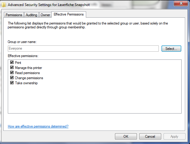

Ok, I have just tried this. I made sure if saved the permissions, then I tried making the change again. I received the same error. I am logged in as a local admin. I also have tried the same on another windows 7 computer on another domain and receive the same error. Would this be considered an issue windows has with snapshot, or a snapshot issue itself?
It would an issue with windows
