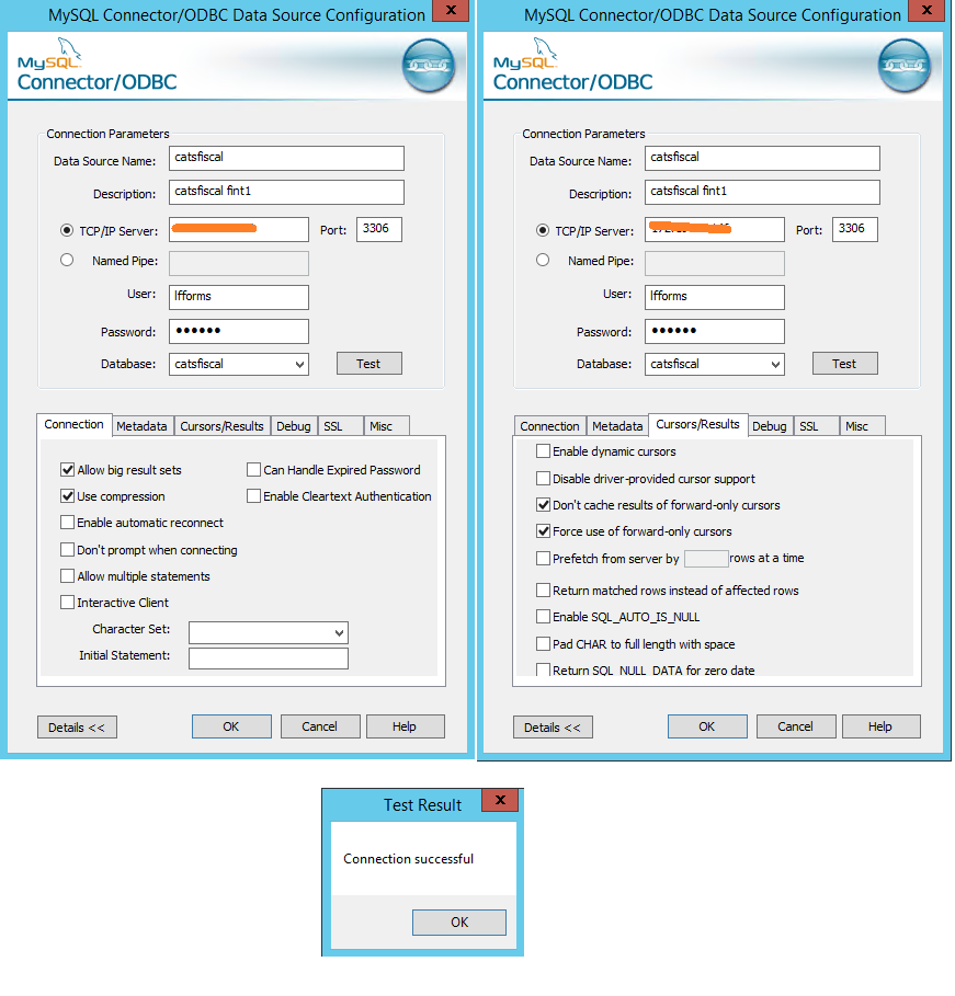

1. Set up a user lfforms (PHPMyAdmin) in MySQL. Install and configure the MySQL ODBC driver that tested successfully (see attached).

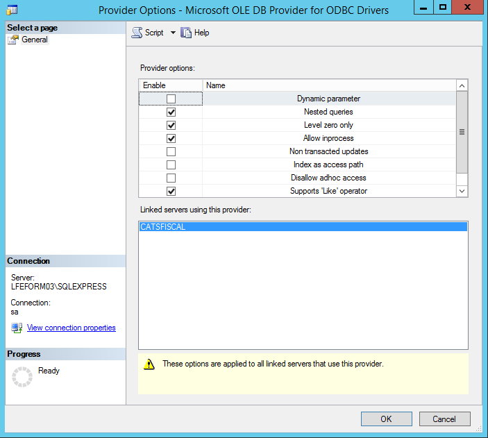

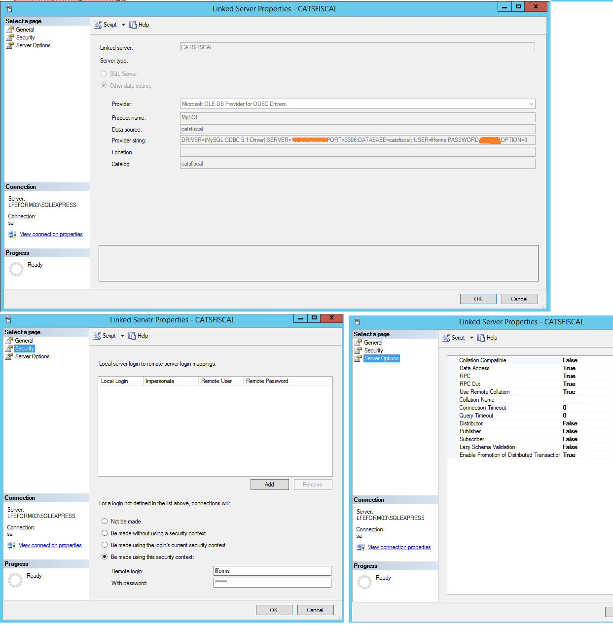

2. Modify the Server Objects / Linked Servers / Providers / MSDASQL properties (see attached)

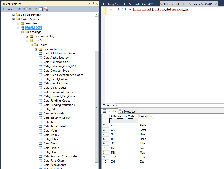

3. In MS SQL Server Management Studio set up a linked server (following various different instructions on the net).
4. Set the new Linked Server properties (attached).
5. I can view the database and all the tables as well as query a simple table (attached).

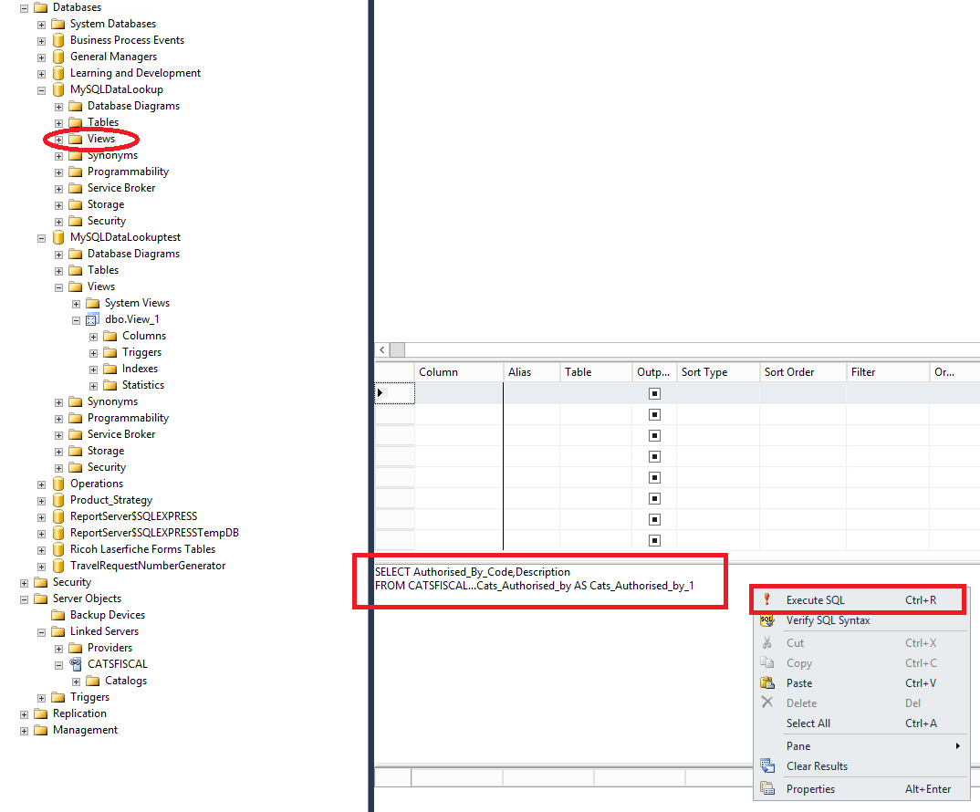

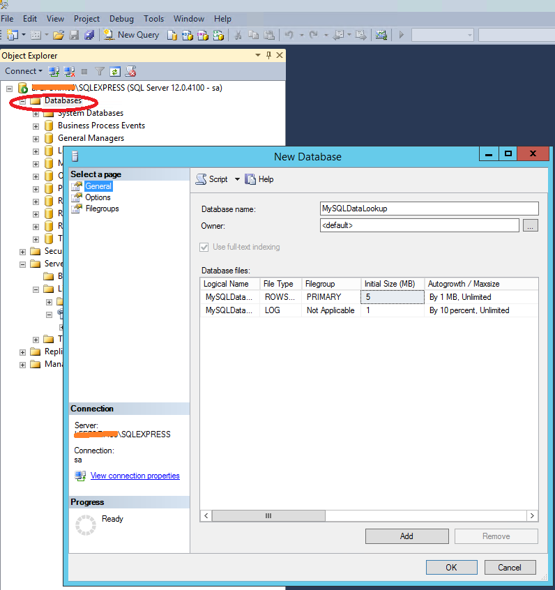

6. Create a New Database in SQL: Right Click on Databases folder | New Database
Name the Data Base | Click Ok (you can adjust further settings here)
7. Create New View: Within the New Created Data Base | Right Click on Views | New View
Close the Add Table pop up box

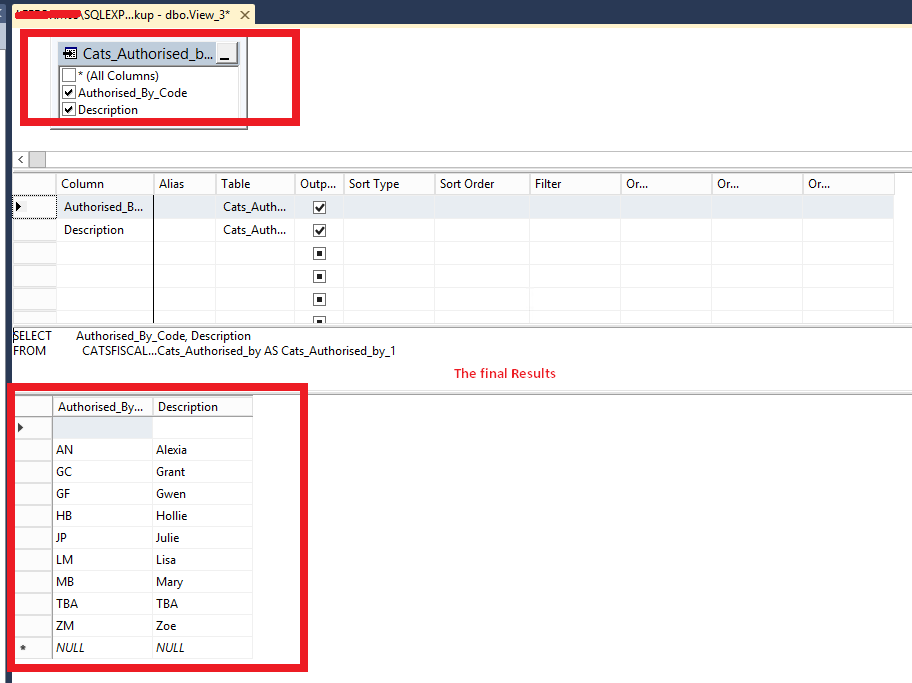

8. Refer to screen shot (Create new View) and enter in the SQL syntax by completing the same pattern by that I have used and specify the columns you require.

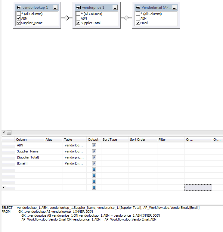

Note: you can take this further by creating joins across multiple tables. I have attache da screenshot of an example my colleague used.
9. Right click and select Execute SQL
10. You should have results from this query displayed (see attached)

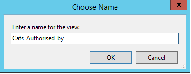

11. Save and name the View (Ctrl-S)

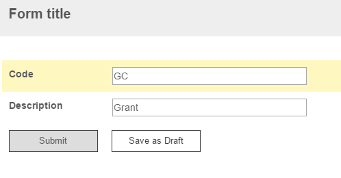

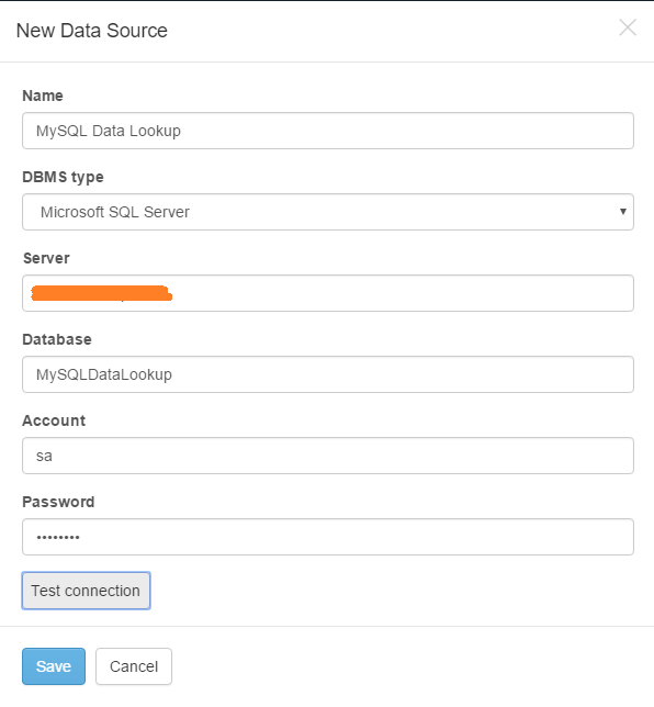

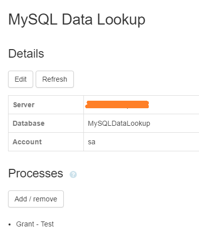

12. Go back to Forms Administration and on the Data Source tab create a new Data Source and test the connection (make sure you have the correct Database name from Step 6).
13. Add your forms Process(s) to this Data Source

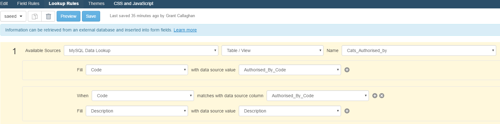

14. Go to your Form process and into the Lookup rules add your new create DB Data source
15. Test and it should work!!!!
