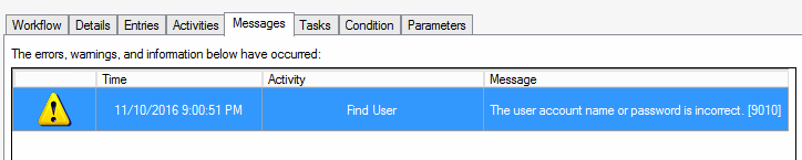

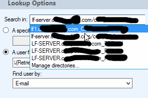

Now we are having an issue with workflows that uses any activities that needs to look up against Trustee Directories. Activities like Find User or Find Groups are throwing warnings such as: There are only Laserfiche Trustee users. Since we moved from LFSERVER to LF1, applying the redirects and having to change system host file doesn't seem to have any effect on this. It only works if we go ahead and republish this workflow with the new Trustee Directory. This adds lot of time since there's over hundreds of workflows to go through and was hoping the redirects should have taken care of that.
This is what I see before making any changes to individual workflows:

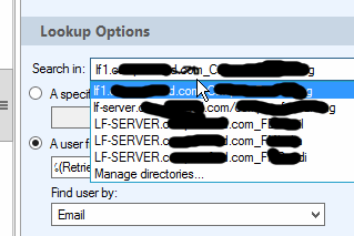

(Might not be related but Oddly enough, switching them to the new Trustee Directory changes the token name "E-mail" to "Email")
This is after I made the change:
Just to wrap up here, my concern is the functionality of redirects in Workflow. After adding the redirects, I am seeing these errors. Is this expected behavior? I have to go to each workflow and individually update the Trustee Directory on each activity? Please advise.

Find User uses WFUser$ to connect. From the error message and your description, I'm guessing it's getting to the LF Server based on the hosts file redirect, not from the Workflow redirects.
By removing and re-adding the repository, the password for that user was reset. So even though Workflow gets to the right server, the password it has registered for the original repository no longer works. And because the repository was re-registered, it won't attempt to use the new password because that's considered a different repository.
The redirects were intended for the case where the repository is moved or renamed. Re-registering the repository renders them inactive. By themselves, the redirects would've worked, but there are now various changes that it's hard to say what actually happened.
