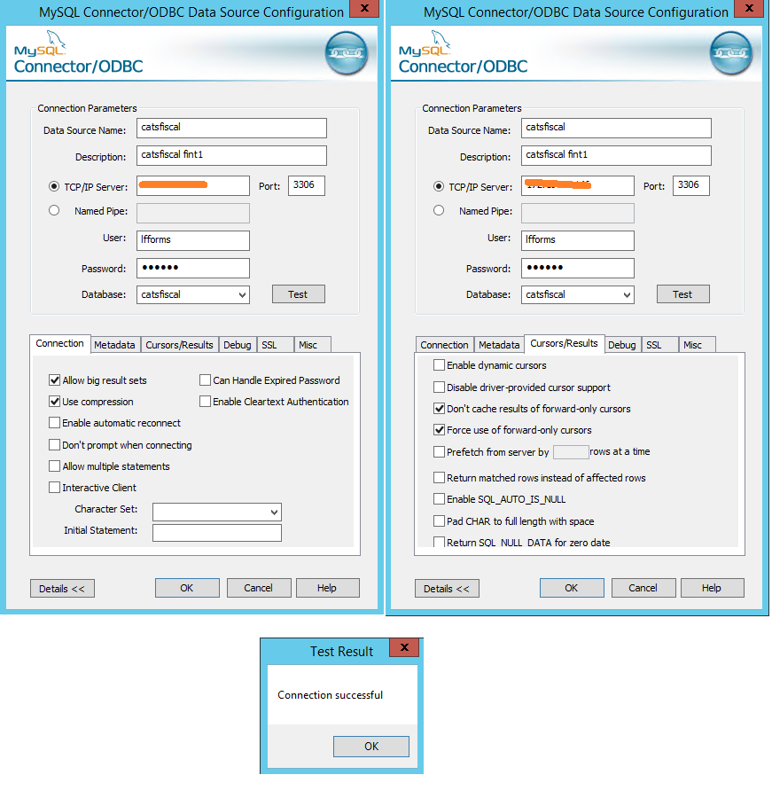

1. Set up a user lfforms (PHPMyAdmin) in MySQL. Installed and configured the MySQL ODBC driver that tested successfully (see attached).

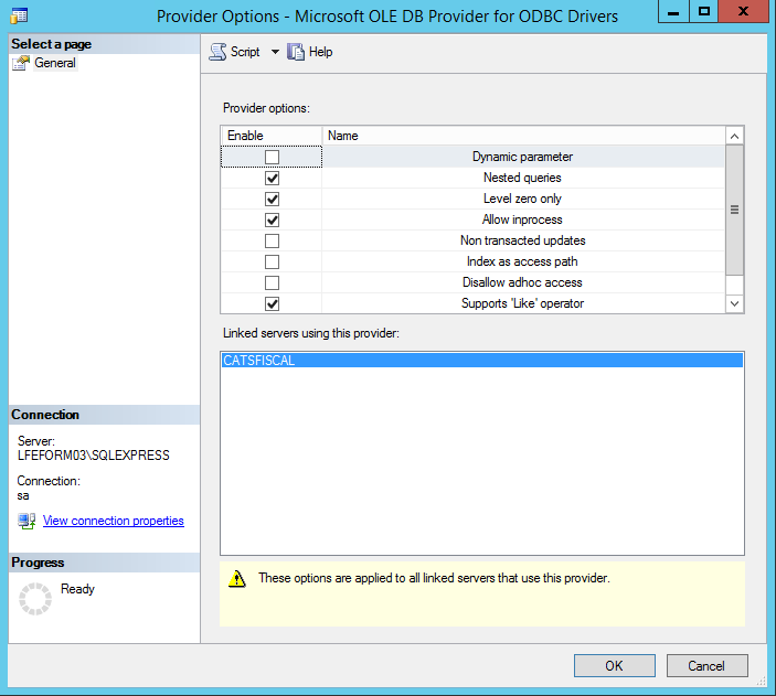

2. Modified the Server Objects / Linked Servers / Providers / MSDASQL properties (see attached)

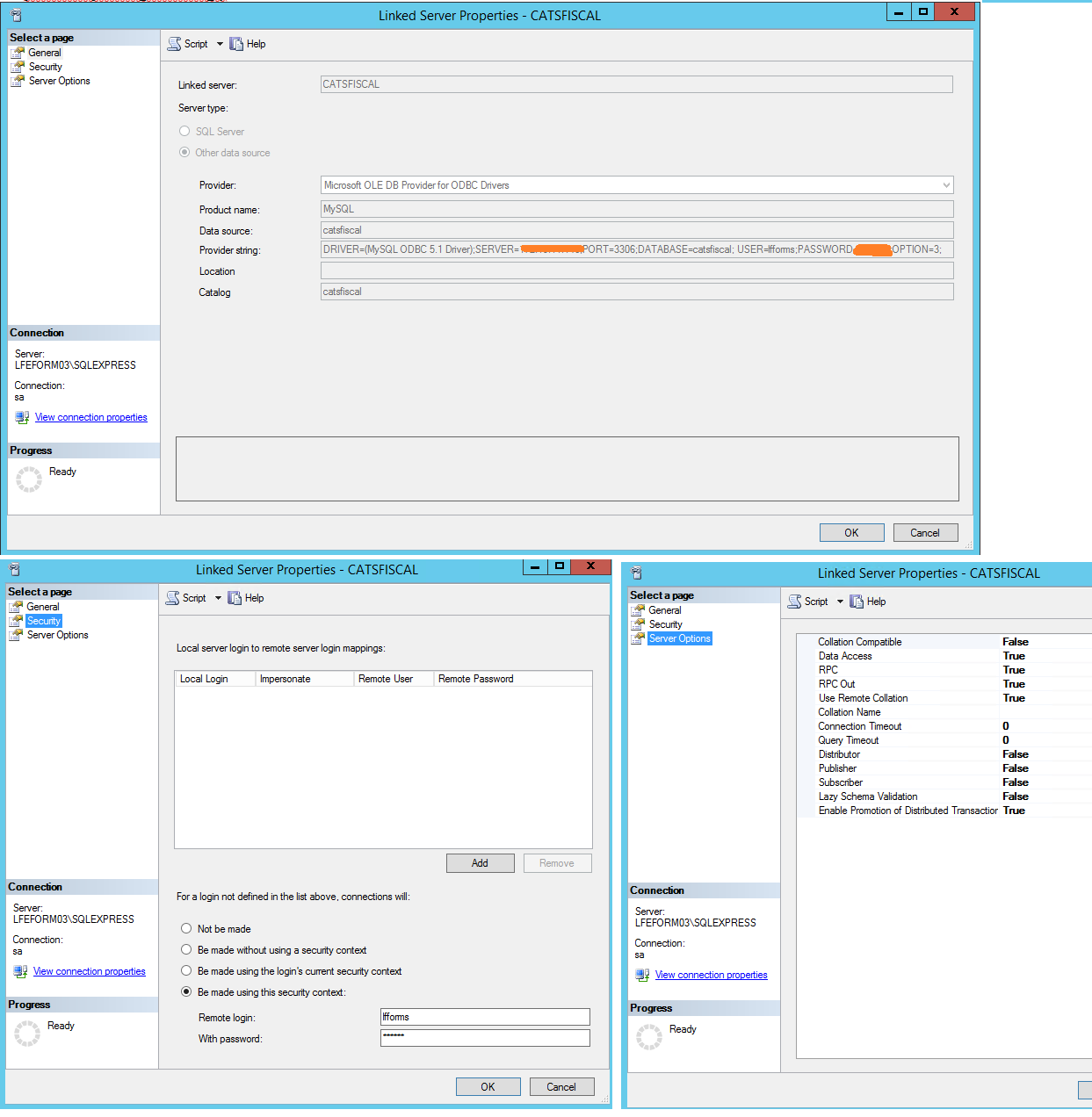

3. In MS SQL Server Management Studio set up a linked server (following various different instructions on the net).
4. Set the new Linked Server properties (attached).

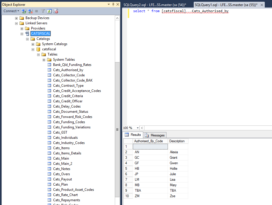

5. I can view the database and all the tables as well as query a simple table (attached).

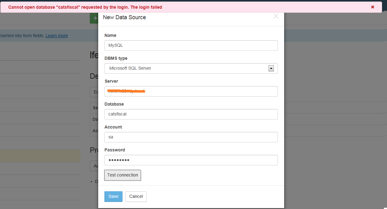

6. In the LF Forms Administration Data Sources page, I am unable to set up a New Data Source to Microsoft SQL (using the MS SQL account) . The error I am receiving is "Cannot open database "data base name" requested by the login. The login failed".
The error log on the SQL Server reavealed:
"2016-11-03 10:37:28.84 Logon       Error: 18456, Severity: 14, State: 38.
2016-11-03 10:37:28.84 Logon       Login failed for user 'sa'. Reason: Failed to open the explicitly specified database 'catsfiscal'. [CLIENT:  ip address of the SQL server is displayed here]"
